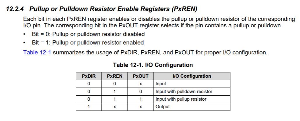

Does MSP430F5529 support Pull down configuration for onboard switches? By using Pull up configuration it is working properly but if I configure in pull-down mode it is not working. So I need to get clarified whether it supports pull-down configuration or not.
