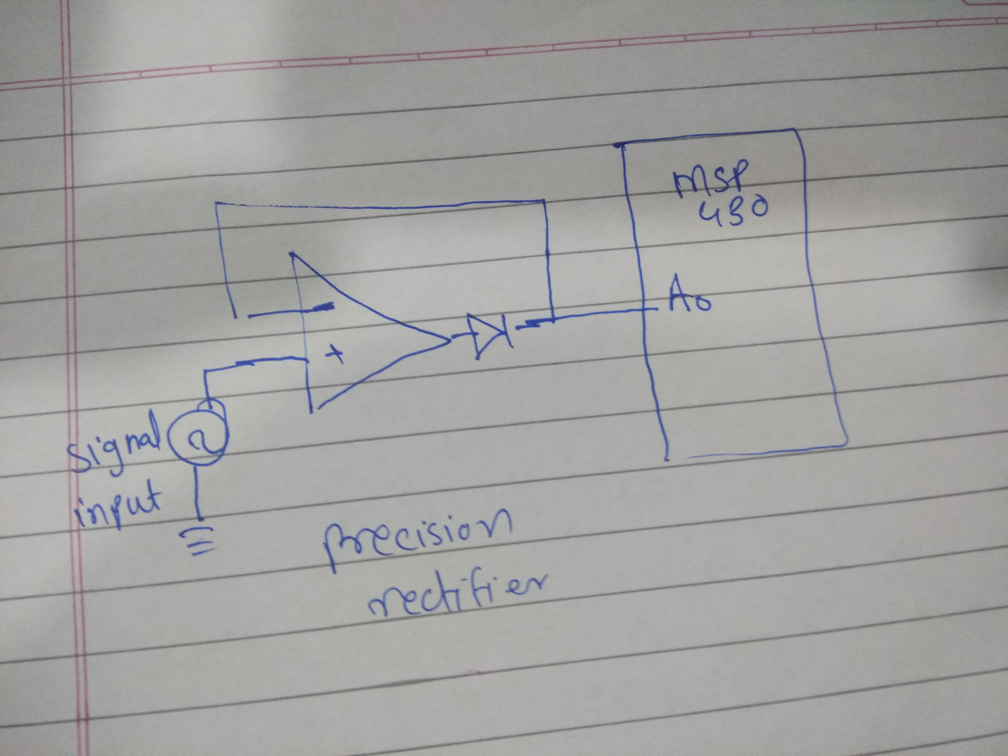

I am using MSP430G2553 to sample the analog input and process it further. When I checked voltage at ADC input pin A0 it was arround 1.4 V  even when input was not connected. Then I tried to pull down it externally then it fall to 1.1 V  instead of 0 V. I need tristate input of ADC as I am giving input from precision rectifer ,due to this I was not able to detect input level less than 1.4 V.  Here is its code.

    What is your input source? SHT=0 is pretty short if your source isn't fairly low impedance.
  • Does this mean that A0 is producing correct results now?
    A0 never produced the wrong result.but the problem of pin voltage around 1.5 V still presents with channel A0 after removal of jumper, due to this when input is given through precision rectifer it is not sampling the input when it is less than 1.5 V because precision rectifier will not work when voltage at it's output terminal greater than input(I have attached the interfacing diagram of signal souce with ADC through precision rectifier). Therefore that pin(ADC input) must be tristated in my application.

    I'm not sure I understand the effect of the rectifier, but I'm not a EE.
  • The output of the rectifier should be very low impedance and be able to drive the MCU input with no issue.
  • Because of that diode your signal source can only source current. You need something on the ADC side of that diode to sink current or it will just float around. A 1K resistor should do the trick. Although it could vary depending on sampling time.
  • A moderate load resistor should do the trick. Generally, you follow a precision rectifier with some sort of peak detector.
  • A 1K resistor should do the trick.
    I tried that too but did not work in my so I added buffer stage in between MCU and rectifier. Now it is working properly
