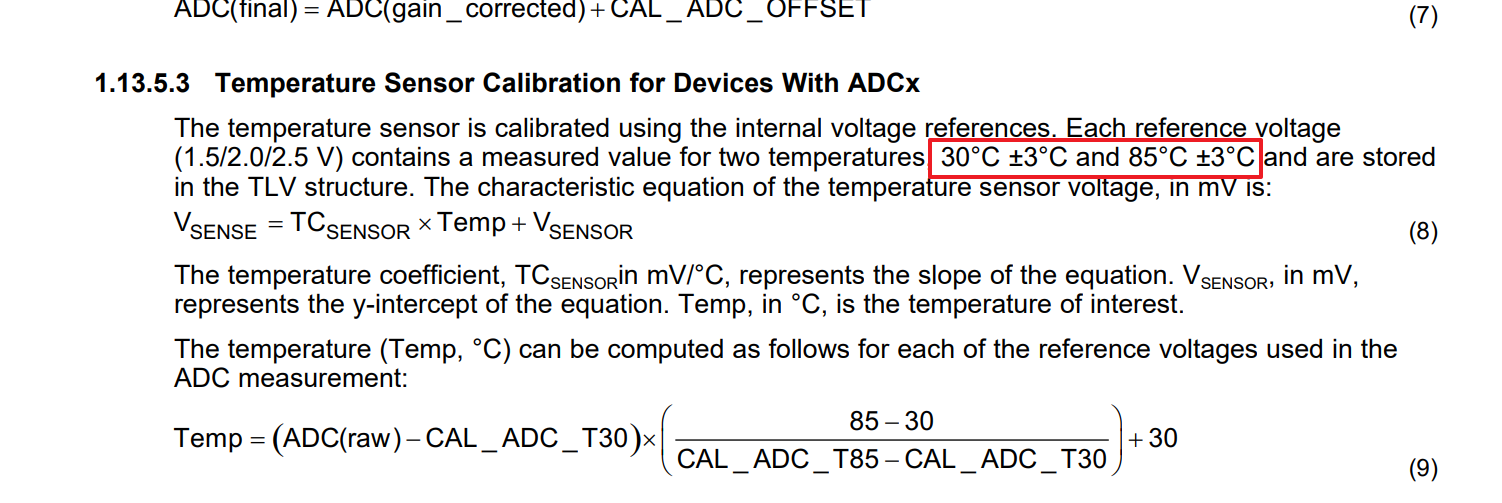

What is the max, min value of temperature which MSP430F6779A can measure? I cannot find in the datasheet? is it –40°C to 85°C ? and how the accuracy of the temperature?

You can find the following figure in the user guide. The temperature measurement range is approximately –40 ° C to 85 ° C.
For the second question, our internal temperature sensor circuit is simple, so the data may have some offset. It is strongly recommended that the user calibrate it before using, and the accuracy is around ± 3 ° C.
