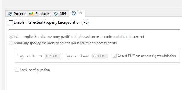

Main program has IPE and data. If location of ipe area is different in new version of the main program, it doesnt work.
The Problem is That:
Ipe segments values (MPUIPSEGB2) are returning first main programs' values. I am trying to change but after RESET, segment values are returns their first values.
New program already comes with its own IpeStruct values and the other codes. But new ipe area is not set in its segment values.
How I am able to manually change IPE area start address? Is there any special method?

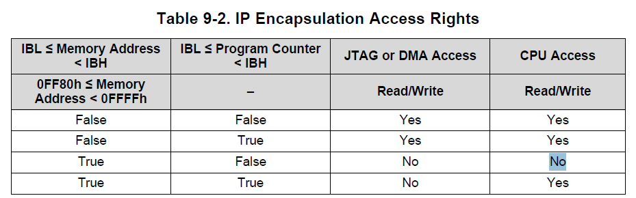

    Before you change vectors and signatures from 0xFF80 to 0xFFFF you must disable the IPE
    To configure the segments, a lower (IBL) border and a higher (IBH) border are positioned by control register bits MPUIPSEGB1[15:0] and MPUIPSEGB2[15:0], respectively, in the MPUIPSEGBx register. We do have a appnote about how to use the IPE http://www.ti.com/lit/an/slaa685/slaa685.pdf

    Debug mode in CCS, Memory Browser shows just 0x3FFF for IPE area. After unlock and disable function, I am able to see real data in this area. Then, I am changing  MPUIPSEGBx registers, ipe_struct_pointer and ne ipe_structure with the code below. Finally, I am locking and enabling MPU and IPE features.
    After BOR reset, MPUIPSEGBx return its previous values

    For applicatin A, IPE disabled.
    For applicatin B, IPE enabled (segment 1 is not manually spesified).
    I change the IPE configuration for program B in CCS and build application again.(new version of B)
    While app A is running, I am also able to erase app B. Then, I download  newer version fo B via UART. Switched to B (with BOR reset).
    After all, I still see IPE config belongs to previous version of B. This is the exact point where I am crash.

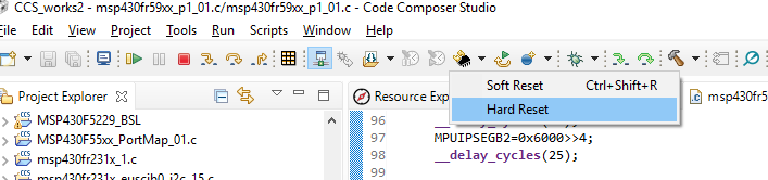

    I have set up the hardware and reproduce this issue with press the reset button to generate the BOR in debug mode. But when I use the hardware reset in the CCS this problem is gone just like below
    How do you generate the BOR?
  • Hi
    I got one reason for my situation is that in debug mode I use the the SBW interface that will change the RST pin to communication mode not the reset button so press the reset button will not work. I have try the 4-wire JTAG that will works well without any problem.
    Best regards
    Gary
    Here generating bor reset with code:
    PMMCTL0 = PMMPW | PMMSWBOR
    I am not sure this situation is related with JTAG or SBW. Because, I am also controlling ipe registers with UART commands which is included in application.
    If debug mode failed anyway, you can reconnect without erasing or changing anything. You can use Red Rectangled settings to use debug to reconnect while application is still running.
    Please flash application with CCS and generate BOR or hard reset. After that you will see IPE values from the related location:
    You can try to shift ipe start and end add. in the code. After that please check new ipe area to see if this is really changed. Then generate a BOR. After that re-check ipe setting if still indicates new area.
    You will see ipe registers will show you pre-configured address.
    Thank you..

      while (1)                                 // Test P1.4
        __delay_cycles(2000000);
        if(rest_flag)
        PMMCTL0 = PMMPW | PMMSWBOR;
  • Hello from the new year :)
    Yes, this is a solution to change ipe setting at the beginning of main but, I am looking for if there is a better solution.
    After updating application B via application A (bootloader app.), application B runs with new MPU setting, new Jtag password etc. without any new code at the beginning.  Except IPE settings, everything works same like that I flash program via CCS,
    I want to know what is the reason of that. Can default IPE settings be only changable via MSP_Fet or any debugger?
    Thank you,
    Best regards...
  • Hi
    I have mentioned it before that we can just to reconfigure the IPE registers after BOR. You can refer to the user's guide section 9.5
    Best regards
