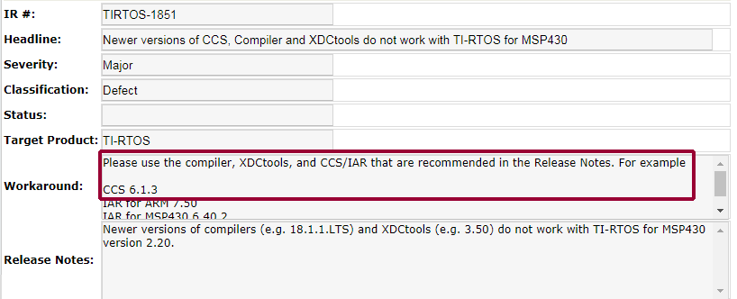

After looking up online on why it might not be working, I came across this:
Fig. 1 - Screenshot of TIRTOS known issue 1851

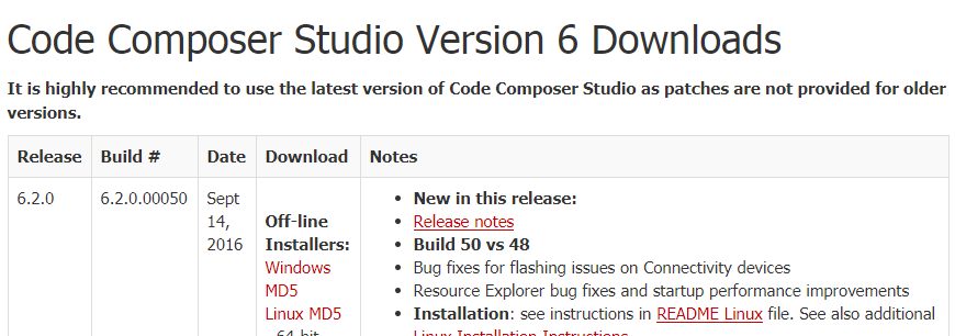

Since CCS 6.1.3 has been superseded in late 2016 / early 2017 (so pretty much 3 years ago), and there is now an explicit advice not to use older versions,
we are now wondering whether that means that MSP430 are generally not well supported in 2019+.
Fig. 2 - Screenshot of recommendation for usage of newest version of CCS taken from CSS download page
So all in all, would you recommend to switch to another controller type or toolchain, or is using the MSP430 with the old tools still a good idea?
