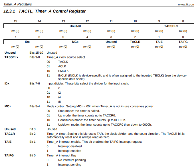

My setup:
  // Timer A0 Initialization.
  TACTL  = MC_0;         // Shut down Timer A0.
  TACTL  = TASSEL_1;     // Select ACLK as clock source and divide by 1.
  TACCR0 = 480;          // Set compare register for ~ 30 usec.
  TACTL |= TAIE;         // Timer A interrupt enable.
  TACTL |= MC_1;          // Set timer A to up counting mode.

  • The Timer A0 Initialization sets the Timer A interrupt enable bit TAIE:
    Which from the description of the TACTL, Timer_A Control Register in the MSP430x2xx Family User's Guide  enables the TAIFG interrupt request:

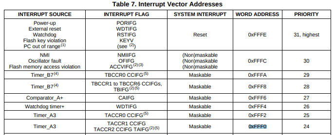

    The MSP430F23x, MSP430F24x(1), MSP430F2410 Mixed Signal Microcontroller datasheet shows that the TAIFG generates the interrupt vector address of 0xFFF0:
    The ISR handler is placed at the TIMERA0_VECTOR which from the msp430f249.h include file is address 0xFFF2:
    #define TIMERA0_VECTOR          (25 * 1u)                    /* 0xFFF2 Timer A CC0 */
    Since the code doesn't have an interrupt vector for address 0xFFF2 this explains why the ISR trap is entered.
    Suggest change the code to place the ISR handler as the TIMERA1_VECTOR which from msp430f249.h is address 0xFFF0:
    #define TIMERA1_VECTOR          (24 * 1u)                    /* 0xFFF0 Timer A CC1-2, TA */
    I.e.suggest change your code to:
    #pragma vector = TIMERA1_VECTOR
    __interrupt void evTMR_A0_isr(void)

  • Harvey Novak said:
    However, the CPU now traps in the routine listed below.
    All I am trying to do is generate an interrupt every 30 microseconds that executes a few lines of code listed in the last submission.
    There are some timer examples under http://dev.ti.com/tirex/explore/node?node=APbNbwzUDwYij82MW9a0-g__IOGqZri__LATEST
    Harvey Novak said:
    Do I need to reset the Interrupt flag?
    Given that the initial code enabled TAIE my initial suggestion was to change to use the TIMERA1_VECTOR. When using the TIMERA1_VECTOR, the TAIV Interrupt Vector Generator is read in the interrupt handler to obtain and then automatically reset the interrupt source.
    For what you are are trying to do, instead enable CCIE for the CCR0 interrupt and then in TIMERA0_VECTOR ; since the TACCR0 CCIFG flag is automatically reset when the TACCR0 interrupt request is serviced. See http://dev.ti.com/tirex/explore/node?node=AE7d65o1rSsbd3neDW0vpg__IOGqZri__LATEST for an example.
