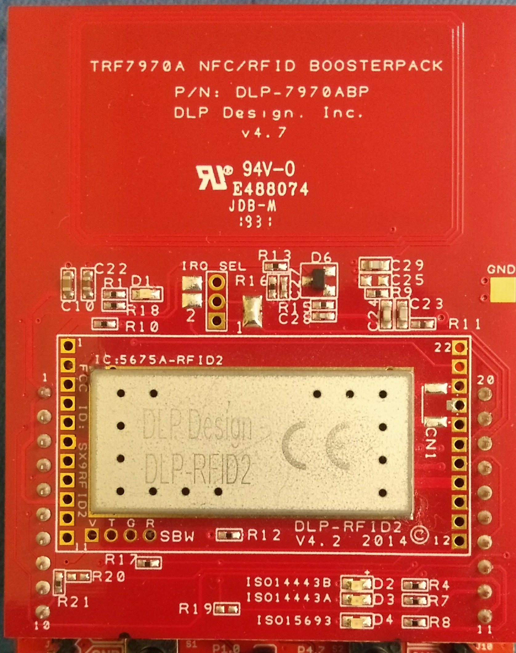

I am using the Hardware combination MSP-EXP430G2ET + DLP7970ABP (V4.7) for Mifare classic authentication process.

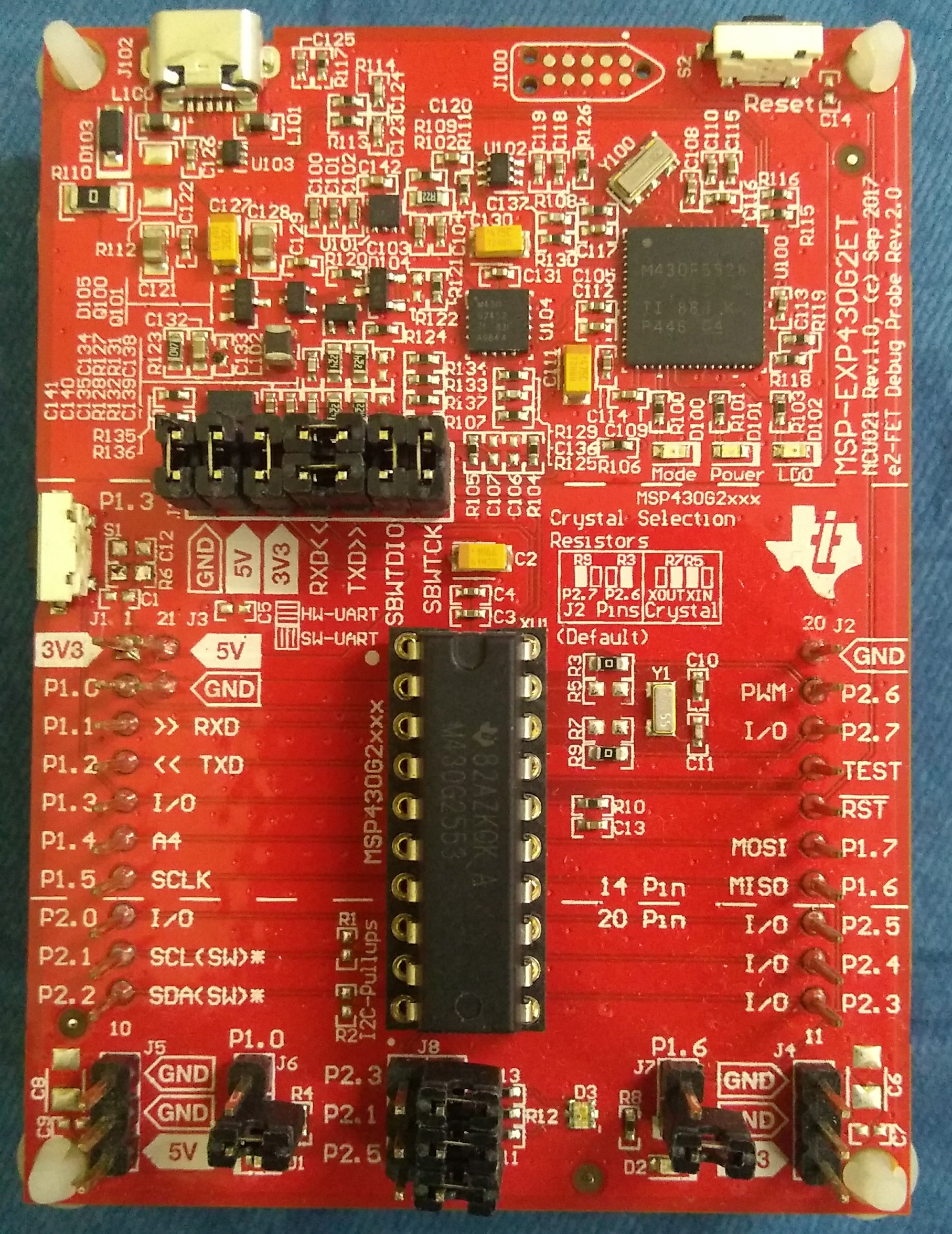

Changes made to MSP-EXP430G2ET are,
  1.  Enabled HW UART in J101,
  2. Opened J7,
  3. Opened J6,
  4. Removed R6.(Removed R6 only after facing this issue, thinking pull up on switch button is causing the above problem. But same behavior with and without R6).
Please let me know if any other HW change is required.

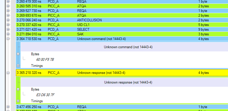

  • HI Sunil,
    I have put your code to my system and found out that after the Anti-collision sequence nothing more is transmitted, which explains why you do not receive any data from the card.
    You have made a lot of modifications to the Mifare_SDM_Transmit routine and added an ISR for the Port 1. After restoring the Mifare_SDM_Transmit routine back to the original code and removal the Port 1 ISR the TRF7970A is transmitting the data 60 00 F5 7B  and the card sends back some data. Please see the attached screenshot. I am not familiar with the Mifare Authentication so please check if this is what  you want to see.
    Helfried
  • Hi Helfried,
    Thanks a lot for your efforts.
    I can say that the data 60 00 F5 7B transmitted by TRF7970A is correct. But after that we cannot say the expected data because of the Mifare Authentication protocol. But the expected data bytes from the card is 4 bytes as in your case. After that TRF7970A will transmit 8 bytes of data and the card will again respond with the 4 bytes data. After this the Mifare Authentication process is completed and should pass. Is it possible for you to check this?

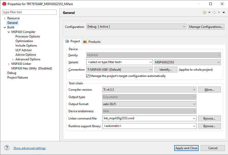

    The MIFARE Classic procedure with SDM is extremely timing sensitive in order to both trigger Special Direct Mode to function correctly as well as transmit and receive data using BitClk.
    The time period of SDM_Bitclk needs to be 9.44 us or very, very close to that.
    The MSP430G2 should run at 16 MHz. That is the speed the MSP430F2370 was running. It is recommended to use the same speed as if you are using an MSP430 at the same clock speed than you do not need to mess with any timings and can keep the routine untouched.

    I don't need any timing adjustments or I don't need any modifications in the SDM process. All I want is that the given SDM sample SLOA214 to work in my (DLP7970ABP + MSP-EXP430G2ET) setup.
    You are saying that MSP430F2370 was running at 16MHz, but in the SDM sample source code I can see that BCSCTL1 = CALBC1_8MHZ; and DCOCTL  = CALDCO_8MHZ; By this I understand that the MSP430F2370 runs with internal DCO at 8MHz. Please let me know if I am wrong.
    If everything should work when MSP430G2 runs at 16MHz, Can you please check the same with the (DLP7970ABP + MSP-EXP430G2ET) Hardware and Code that you already shared with me and confirm? I just want to make sure that there are no problems with my hardware or its settings.

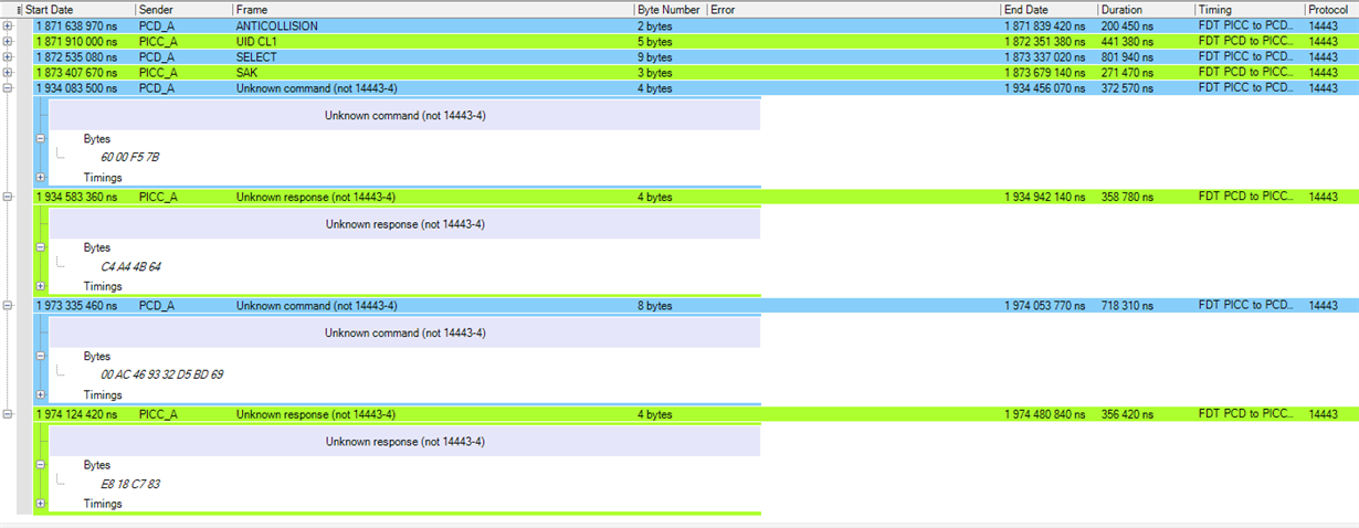

  • Hello Sunil,
    I use a Mifare Classic 1K, so your card is ok.
    I put here the data capture of my Logicanalyzer as reference for you. You can check if there is a difference to your capture.
    Mifare_Autentication.zip
    Also a screenshot of a my spy:
    Helfried

    3. My doubt next shifts to the Hardware, I am using the DLP-7970ABP v4.7 and MSP-EXP430G2ET Rev.1.0 Sep2017 boards operating at 3V Vcc.. Please let me know the version of boards that you use and the operating voltage. Also please recollect and check and let me know whether you have made any changes to the hardware setup.
    I further debugged and probed the RF signal at the 19th pin of the 22pin DLP-RFID2 module (as I could not find RX1_AM and TX_OUT pins of TRF7970A separately in DLP7970ABP). I can see that the RF signal suddenly goes OFF during the DM1_Receive. I have attached the images for your reference. I hope the RF signal should be present during both Transmit and Receive functions. I couldn't understand the reason for this. Please let me know if you had faced this issue already or any idea about this. Please let me know how to proceed.
    Please help me and provide your guidance to solve this issue. Thanking you.

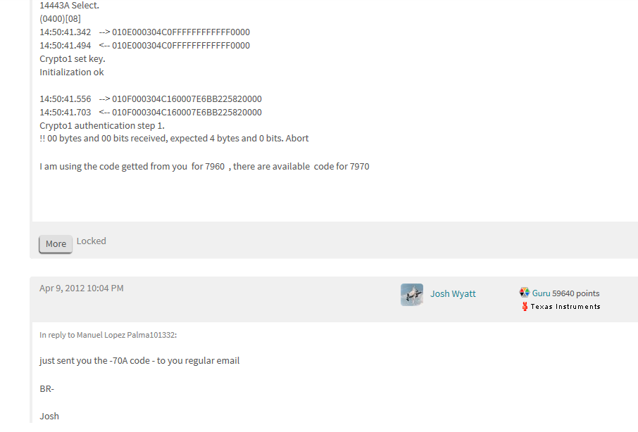

    Meanwhile, I just saw a E2E forum with a similar problem related to authentication already solved. In that "Manuel Lopez" has reported that he didn't get any response from tag for "Crypto1 Authentication Step 1" and the solution given for that was a code specific to TRF7970A. Though it is related to DM0 mode, I wonder whether me too need to change my code specific to TRF7970A?? Please find the link of that E2E forum below for your reference. Can you please look into it and let me know if you get some clue?
    Thanks and Regards,
    Sunil
  • Hello Sunil,
    All our MIFARE Classic examples are for the TRF7970A.
    The code referenced there was an old Direct Mode 0 code that was hacked together to work and isn't compatible with our EVMs nowadays anyways. I've never even tested or used it, and I've been working with the device in 2014.

    Here are pictures of my boards
    Screenshot of the used Compiler:
    Finally the CCS Project.
    E2E_Mifare_2020_03_03.zip
    The Card I used for the test is a Mifare Classic 1K.
    Hope that helps to verify our setups.
    Helfried
  • Hi Helfried,
    Thanks for your response. Hope you are doing good.
    I find some difference between your setup and mine. I have the MSP-EXP430G2ET Rev 1.0 dev kit and yours is MSP-EXP430G2. I have  DVP7970ABP v4.7. Please refer the attached image. I suspect this could be a reason for not working on my side. Please let me know.
    This time, I can load the binary in debug folder in this project, but still the same behavior. Mifare authentication is failing. Please refer the debug print below.
    I hope this will make you understand what is happening on my side.
    MSP-EXP430G2ET:
    DLP7970ABP V4.7
    Project Property:
    Debug Msg:
    Thanks and Regards,
    Sunil

    With Helfried's V4.5 hardware I am also not able to pass auth which is very strange. Unfortunately due to COVID-19, I am currently lacking some pieces to try and debug the issue fully. TBD on when I will be able to get what I need on my end. Though I am working w/ Helfried on some debug activities, if any of those bare results, I'll let you know immediately.
  • Hi Ralph Jacobi,
    Thanks for your efforts. I hope now you can understand the issue on my side.
    From your statement, my understanding is that you tested with Helfried's binary/source code. Please confirm.
    Which LaunchPad did you used with V4.5 DLP7970ABP? I am having MSP-EXP430G2ET Rev1.0. Helfried is having MSP-EXP430G2 Rev1.5.
    I suspect whether the difference in the Launchpad is causing some issue?
    Thanks and Regards,
    Sunil
  • Hello Sunil,
    There is something else going on as I also have MSP-EXP430G2 Rev 1.5 & DLP-7970ABP Rev 4.5 and am not able to auth the tag. I am going to review some LSA traces between Helfried's system and my own.
    And yes I am testing w/ Helfried's source code.
  • Hello Sunil,
    After reviewing the LSA traces from Helfried's working example and my own LaunchPad as well as source code, I was not able to trace the root cause for the issue from a firmware standpoint. My theory at this point is that the physical header connections for the BoosterPack is not allowing the DM1 signal to be transmitted as cleanly.
    The example itself was never designed with the BoosterPack + LaunchPad interface in mind, and these RF signals are very sensitive. Small changes or delays could impact the reading. This is the first time we'd ever tried to do a Direct Mode 1 implementation of any sort with the BoosterPack. It would also explain why two identical sets of hardware would have differences.
    At this time, we are not in position to do re-development in order to solve the issue on the BoosterPack. The original firmware writer who had the in-depth expertise with Special Direct Mode is no longer part of the team and we do not have an equivalent expert. Furthermore, there is doubt that the issue can even be solved with firmware adjustments due to the unique nature of the header connection presuming that I am correct about the issue being rooted in the RF signal being transmitted over the BoosterPack header. We will add the item as a 'to-do' but as a low priority item, so I would not have a time estimate to when it will be tackled.
    While I understand this doesn't exactly help your situation, we are basing the decision of this being low priority off the fact that many customers have successfully designed their MIFARE Classic systems based on the app note without the TRF7970AEVM available and so right now we only see a very limited need.
    As far as a path forward for you, if you could design an equivalent to the TRF7970AEVM where the TRF7970A and MSP430F2370 are connected on the PCB and not via headers, I feel strongly that you will be able to make this system work. If it is feasible for you to design a test PCB based on our EVM reference design and you want to do a schematic review before fabrication, let us know and we can make sure the schematics are accurate.
