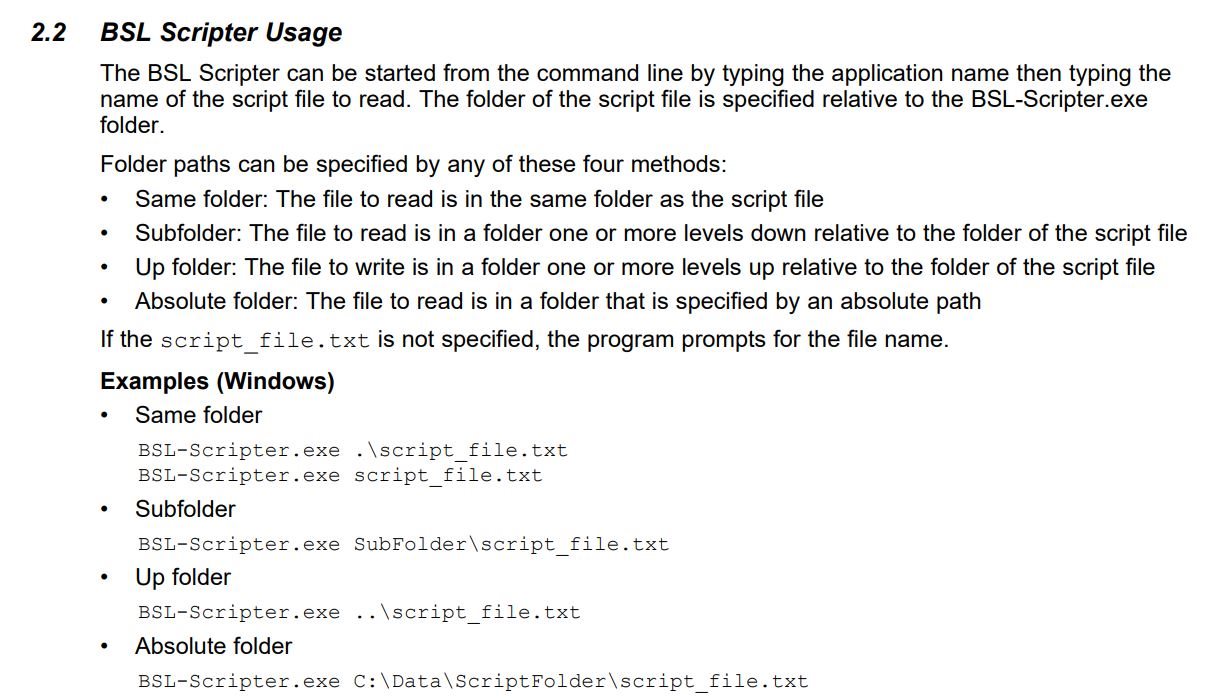

  • Yes, I think you have lost in mass information. But I have gave the useful resources link MSPBSL, which includes tools, setup, steps. Since the BSL is not in few words, you still need few hours to learn how to use them.  I summary the key steps you need to do:
    1. For software tool, you need download  BSL-SCRIPTER, which is a command line application that performs the commands or script to flash device.
    2. For hardware tool, one of the MSP-FET, MSP-GANG and MSPBSL_Rocket_FW is OK. The F5172 supoorts BSL through UART communication. It means you need make a connections between F5172 and MSP-FET or other tools as below.
    For F5172, it should be P3.7 as TXD, P3.6 as RXD for 40-pin package. Please get actual TXD/RXD from below table for different packages.
    3. After downloading the BSL Scripter, and making correct connections, you need run the BSL Scripter with a unlock device example script. To run the application, please follow below example.
    There are some script examples within BSL Scripter download, including JTAG unlock example.
