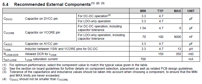

My customer is evaluating MSP432P40R and built their own board.
They have JTAG connection issue on their board and found Xtal for 32.768KHz and 24MHz are not working.
We checked the schematics and found VCORE and VSW are NC on their board.
I think an external capacitor is needed at least for LDO only mode.
What happens if VCORE and VSW are NC?
It is expected external oscillators do not work?
