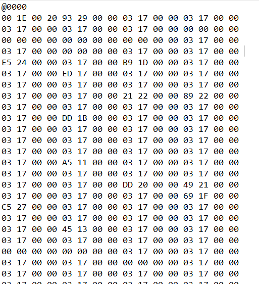

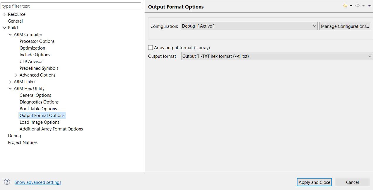

Here is my application .txt output format setting:
Here is my application .txt code:

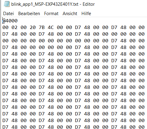

And here is the example txt application from BSL Scripter:

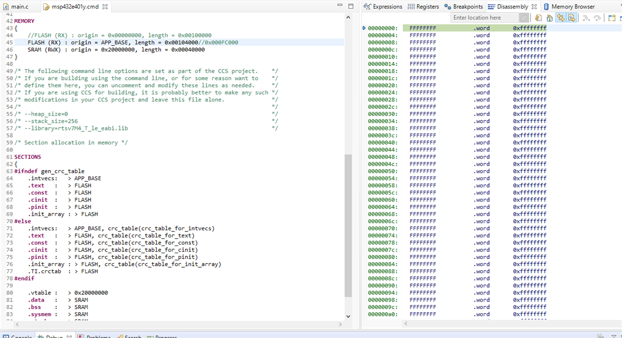

  • On the "MSP432e401y.cmd" file i could change the APP_BASE Address to 0x00004000:
    /* Suppress warnings and errors:                                            */
    /* #10199-D CRC table operator (crc_table_for_<>) ignored:
        CRC table operator cannot be associated with empty output section       */
    --diag_suppress=10199
    --retain=interruptVectors
    #define APP_BASE 0x00004000
    MEMORY
        FLASH (RX) : origin = APP_BASE, length = 0x000FC000
        SRAM (RWX) : origin = 0x20000000, length = 0x00040000
    /* The following command line options are set as part of the CCS project.    */
    /* If you are building using the command line, or for some reason want to    */
    /* define them here, you can uncomment and modify these lines as needed.     */
    /* If you are using CCS for building, it is probably better to make any such */
    /* modifications in your CCS project and leave this file alone.              */
    /* --heap_size=0                                                             */
    /* --stack_size=256                                                          */
    /* --library=rtsv7M4_T_le_eabi.lib                                           */
    /* Section allocation in memory */
    SECTIONS
        .intvecs:   > APP_BASE
        .text   :   > FLASH
        .const  :   > FLASH
        .cinit  :   > FLASH
        .pinit  :   > FLASH
        .init_array : > FLASH
        .vtable :   > 0x20000000
        .data   :   > SRAM
        .bss    :   > SRAM
        .sysmem :   > SRAM
        .stack  :   > SRAM
    __STACK_TOP = __stack + 512;
    This changes the main address on flash but i the debugger doenst put a breakpoint in main().
    I cannot start the program code and in the disassembly it stays here:
    This is what the debugger verbose output:
    CORTEX_M4_0: GEL Output:
    Memory Map Initialization Complete
    CORTEX_M4_0: Flash Programmer: Verbose output enabled
    CORTEX_M4_0: Flash Programmer: DLL Version 3.3.0.1
    CORTEX_M4_0: Flash Programmer: Found illegal reset vector address
    CORTEX_M4_0: Writing Flash @ Address 0x00004000 of Length 0x00001068
    CORTEX_M4_0: Flash Programmer: Device init finished
    CORTEX_M4_0: Flash Programmer: Programming flash memory
    CORTEX_M4_0: Flash Programmer: Write speed 34.5 kB/sec
    CORTEX_M4_0: Flash Programmer: Exit flash programming
    Any idea? Do i have to change anything else?

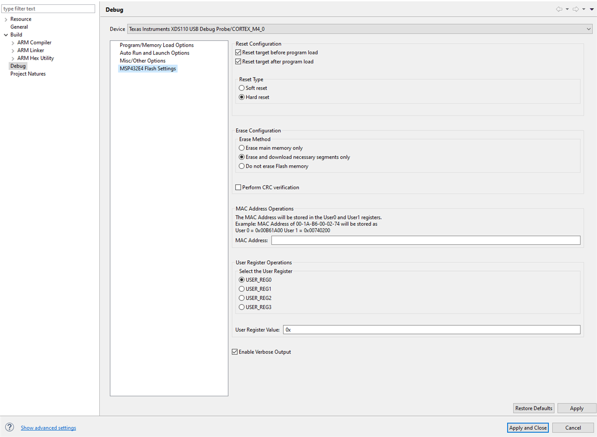

  • Ok i made it to work now.
    On project propreties i set the debug flash settings as followed:
