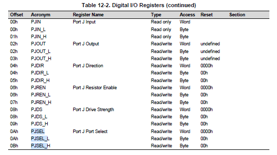

Table 12-2 of SLAU208Q (June 2008–Revised March 2018), the MSP430x5xx and MSP430x6xx Family User's Guide documents the PJSEL I/O register for Port J:
But the device Data Sheet omits this particular register from the Port J register set:
I understand that the Family User's Guide is a superset document for all of the microprocessors in that family and that the Data Sheet for a specific MSP430 implementation always "controls" so I'm asking this just to get confirmation:
Is it really true that the MSP430F5359 DOES NOT contain a "PJSEL" register?
