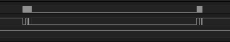

    The arduino scl and sda lines look like this
    But my code output looks like this (msp430)
    I know my code is detecting the i2c device as if i remove it the second pulse no longer exists or if I change the I2C address in the msp code from 40 to something else. But I can not see the data.

  • See my below reply. But
    I now can see data on the I2C data line and the clock running too. However, I am unable to see both bytes of data and the check sum value. Therefore could you please have a look at this code:
    This code is run in a loop and should get the data from the differential pressure sensor however, when I uncomment the reading of the second byte and or the check sum the code looks up and nothing is output and the sda and clock lines both lie flat.

    With the parts of the code uncommitted as such my data and clock lines look as follows:
  • When you request a Start (UCTXSTT) the transaction will start immediately, so you need to make sure everything is in place first. Similarly, you shouldn't read RXBUF until RXIFG is set.
    I recommend  User Guide (SLAU445I) Figures 24-12 and 24-13. There's quite a lot of information in them.
    Specifically:
    >    UCB0CTL1 |= UCTXSTT+ UCTR; // Generating START + I2C transmit (write)
    >    UCB0I2CSA = SDP610Address; // SDP610 7 bit address 0x40
    You should reverse the order of these statements.
