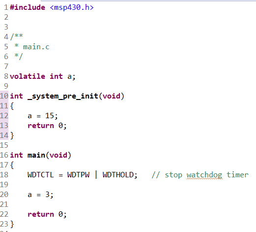

  • Hi Ashish,
    Since you are using CCS, you could write your own _system_pre_init() function and have it return 0.
    And then it'll call your _system_pre_init() function and then go directly to main without any other operation.
    In your _system_pre_init you could choose not use any __TI_Handler_Table_Base or __TI_Handler_Table_Limit symbols.
    I attached an example below. You may run this for a test and should see that by using this, the variable "a" is initialized to "15" instead of the default initialization value "0". Generally in that _system_pre_init() you could write whatever you want prior to your main function and remember to make the return value "0". Also please remember the watchdog is default on so if your _system_pre_init() takes long the MSP430 may reset by watchdog timeout.
  • Hi Harry,
    Sorry for the late response.
    if i'm not wrong, _system_pre_init() will be called by boot.c provided by the TI library? if that the case, I wanted to avoid that path if possible.
