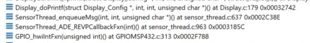

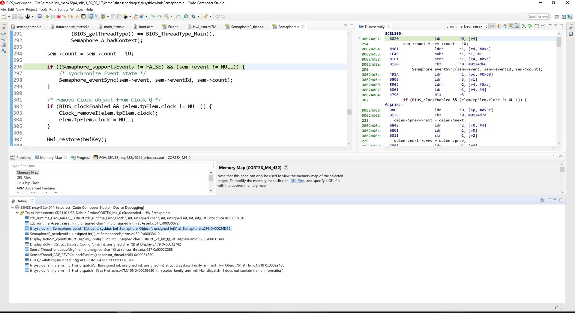

    Now I am getting a few more details on the crash, however I havent been able to resolve it fully yet.
    When I run the code in debug mode with breakpoints at various lines in the code, I get the following data in ROV -
    1) Before I hit the "play" button in the debugger (i.e. the code is halted at the initial point), the SYS/BIOS "scan for errors" console has the following lines -
    ti.sysbios.heaps.HeapTrack	HeapAllocList	HeapTrack@2000c354	overflow	Error: Memory overflow
    ti.sysbios.family.arm.m3.Hwi	Module	        N/A	                hwiStackPeak	Error fetching Hwi stack info!
    ti.sysbios.family.arm.m3.Hwi	Module	        N/A	                hwiStackSize	Error fetching Hwi stack info!
    ti.sysbios.family.arm.m3.Hwi	Module	        N/A	                hwiStackBase	Error fetching Hwi stack info!
    ti.sysbios.knl.Task	        Module	        N/A	                hwiStackPeak	Error fetching Hwi stack info!
    ti.sysbios.knl.Task	        Module	        N/A	                hwiStackSize	Error fetching Hwi stack info!
    ti.sysbios.knl.Task	        Module	        N/A	                hwiStackBase	Error fetching Hwi stack info!
    ti.sysbios.knl.Clock	        Module	        N/A	                N/A	        Caught exception in view init code: "C:/ti/ccs920/xdctools_3_60_01_27_core/packages/xdc/rov/StructureDecoder.xs", line 518: java.lang.Exception: Target memory read failed at address: 0xbebebec6, length: 32 This read is at an INVALID address according to the application's section map. The application is likely either uninitialized or corrupt
    2) Once I hit "play", the errors go away and the RTOS loops in the idle task, waiting for an event to "post". Image below-
    3) When i trigger a GPIO interrupt, following sequence occurs (due to break points in the code)-
    a) Debugger halts at
    SensorThread_enqueueMsg(ST_REVP_EVT, NULL, NULL);

  • Hi Shreyas,
    First, it looks like you do not have any zero-latency interrupts. All the Hwi instances have a priority of 32 or higher. Unless you changed the default disablePriority in the .cfg, only interrupts with a priority of less than 32 are zero-latency interrupts. Note: zero-latency interrupts cannot call kernel APIs.
    Based on the "A_badContext: bad calling context." message. It looks like a Hwi or Swi is calling Semaphore_pend with a non-zero timeout. It's fine to call it with a zero timeout. You have the O_NONBLOCK flag on the mq_open, which means a timeout of zero will be used internally in the mq_send. The problem must be somewhere else. While in main(), please open the disassembly window and put "xdc_runtime_Error_raiseX__E" as the address. Put a breakpoint at the beginning of the Error_raiseX function.
    Run the application to get the error and you should hit the breakpoint. Look at the callstack in the debug window to see who is calling the Semaphore_pend with a non-zero timeout.
    Todd
  • Todd, thanks for the detailed steps. I was able to do this and got the following information -
    The relevant section of code in semaphore.c file is -

    I see that there are 2 Semaphore_pend calls in the in call stack - Semaphore_pend and SemaphoreP_pend. However, I'm unable to pinpoint which entity is calling Semaphore_pend with a non-zero timeout.
  • Actually, doing a bit more digging into this, I found that the fxn Display_doPrintf() is associated with one of the target memory address errors I got earlier. IN my first post, I showed in the ROV that the error was
    Target memory read failed at address 0xBEBEBEBE, length: 8 This read is at an invalid address according to the application's section map.

  • Hi Shreyas,
    You can only call Display_printf from a task (or POSIX pthread). You are calling it from an interrupt.
    Please remove the Display_printf from the SensorThread_enqueueMsg function and see if that helps.
    You can refer to http://dev.ti.com/tirex/explore/node?node=AB7f4Ige5MhJBdj939tqxg__z-lQYNj__LATEST&r=fc2e6sr__3.10.00.04 for more information about restrictions and other debug printing options.
    Todd
  • Todd, thanks for pointing it out. This indeed solved my problem!
    Thank you!
