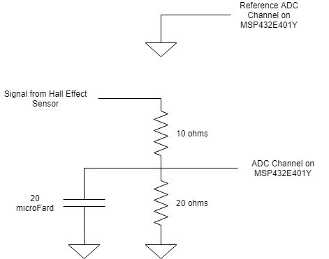

I am currently trying to interface a split core hall effect sensor () to a differential ADC channel on my MSP432E401Y. I am having trouble finding the correct scaling for the step size for 1.0 amps. The ADC channel is being sampled 100 times per second, then the average of all 100 samples is being averaged to come up with an average ADC step value and converted to millivolts. The purpose of the ADC channel is to read in a current of wire and convert the voltage readings it's receiving into the current value that will be saved on a micro SD card.
Here is a link to the limited datasheet for the AIMH021 hall effect sensor: https://aimdynamics.com/product/AIMH021-050A-5VT/
It can output from -5 to 5 volts so I am using a voltage divider of 2/3 to scale the reading to -3.3 to 3.3 range.
The reference voltage for the differential ADC channel is GND but there appears to be a 50 millivolt offset on the GND for the MSP432E401Y Launchpad that is screwing the data.
There is a 10 milifarad capacitor attached from the ADC pin to ground to try and smooth out the noise.
There still seems to be a lot of fluctuation Should there be a low pass filter for the input to the ADC channel?
There is no electronic interface on the AIMH021, just two potentiometers to adjust the reference voltage. I am wondering if someone could point me to some resources that would clean up the ADC signal so it can be read properly.
Here is a diagram of the setup currently for the ADC channel:
Here is a chart of the voltage read by the ADC channel with the corresponding current follwing through the hall effect senor:

  • The AIMH021 VT unidirectional DC current sensor measures up to ± 200Adc and outputs a corresponding + 5Vdc signal
    You have your scaling to 3.33V max.  But I believe the VRef for the ADC blocks is 2.5V.  Either way, lets chew on it some.
    The only advantage to doing this in a differential mode would be to have a long run of wire go to the ground of the sensor.  That way you don't have the voltage drop of the combined grounds from the sensor any appreciable distance.
    The ADC is 12 bits.  That's 4095 maximum count at full tilt input (we will pretend Vref is 3.33 now).  So to get 3.3V on the input (and look at that lowpass cap... )  you have to have 200A going through the sensor.  Since you'll have 1A going in, you'll have 0.0165 volts going to the ADC pin.  This will give you a ADC conversion count of 67... at your rated 1A of current.  And to add a cherry on top; that sensor may not even pick up a signal so far below its rated current.
    Consider using the ACS70331EESATR-2P5U3 by Allegro.  It is DC only, output 800mV per A input, and comes in an easy to use SOIC8 package.  Right now, I suspect your sensor is way overkill.

  • Hi Patrick,
    I think one of the basic problems you're experiencing is the lack of a solid reference. The ADC on this device is either using an external reference, or it can internally switch to use of the analog supply of the device. The Launchpad you're using is only providing the connection to digital supply.
    The quality of the reference voltage is decisive for the resulting ADC performance, as the ADC is referencing the results to this reference. So using the digital supply is certainly not the preferred thing to do, if you'd like to have reasonable performance. To change this, you would have to use an external voltage reference of respective quality.
    Of course also the connection of the reference to the board and ADC needs to be considered, as the best reference will not help you, if the cable connection will pick up noise on its way to the ADC.
    To cut the story short, dependent on what you're shooting for, it might make sense designing a board trimmed for analog performance yourself, as the LPs are usually a compromise between performance, cost and number of features to be demonstrated, and not focusing on analog performance.
    Best regards
    Peter
  • Howdy, Peter,
    Thank you for your reply. I ended up using a lowpass filter and diffrential op amp to clean up the noise from the power supply ground. The diffrential op amp maps the signal from Hall Effect sensor from the +4V to -4V output range to 0V to 3.3V. The with other active lowpass filter at 10Hz to cut out noise from the power supply.
