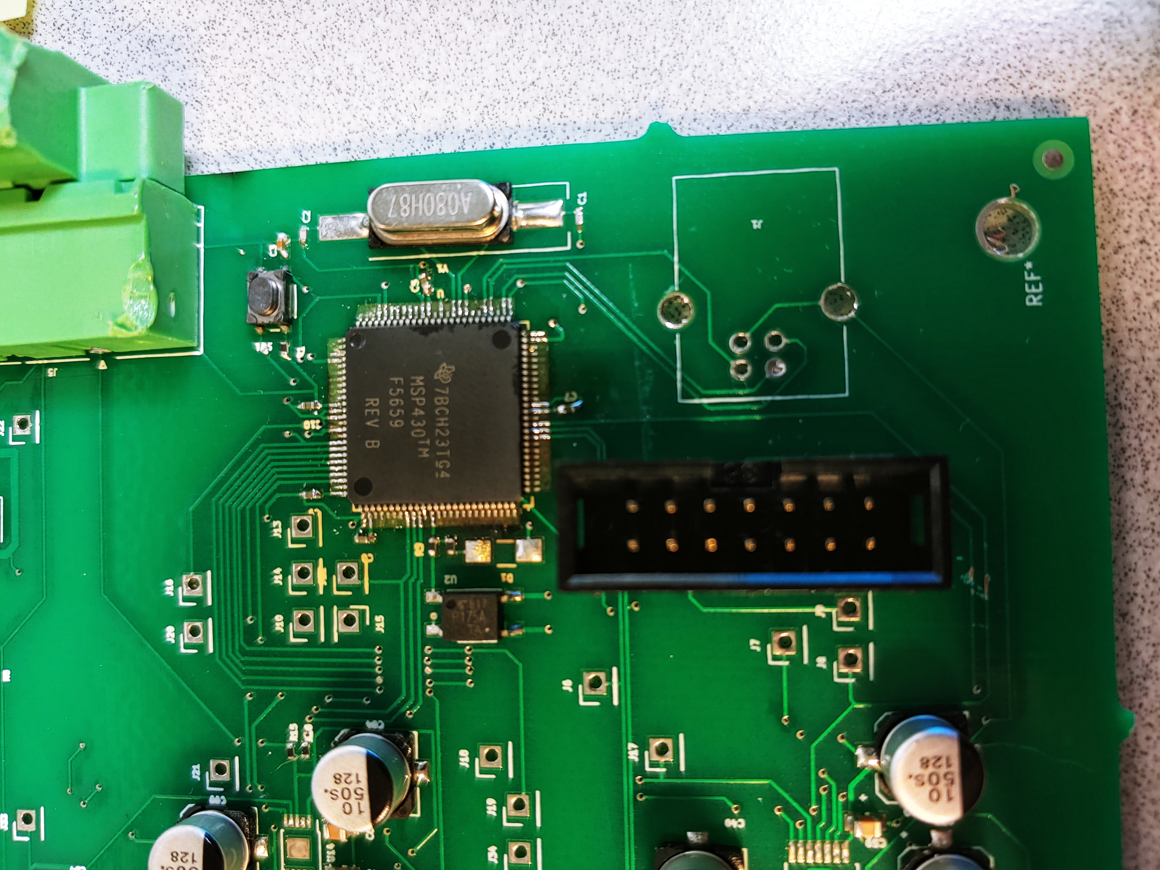

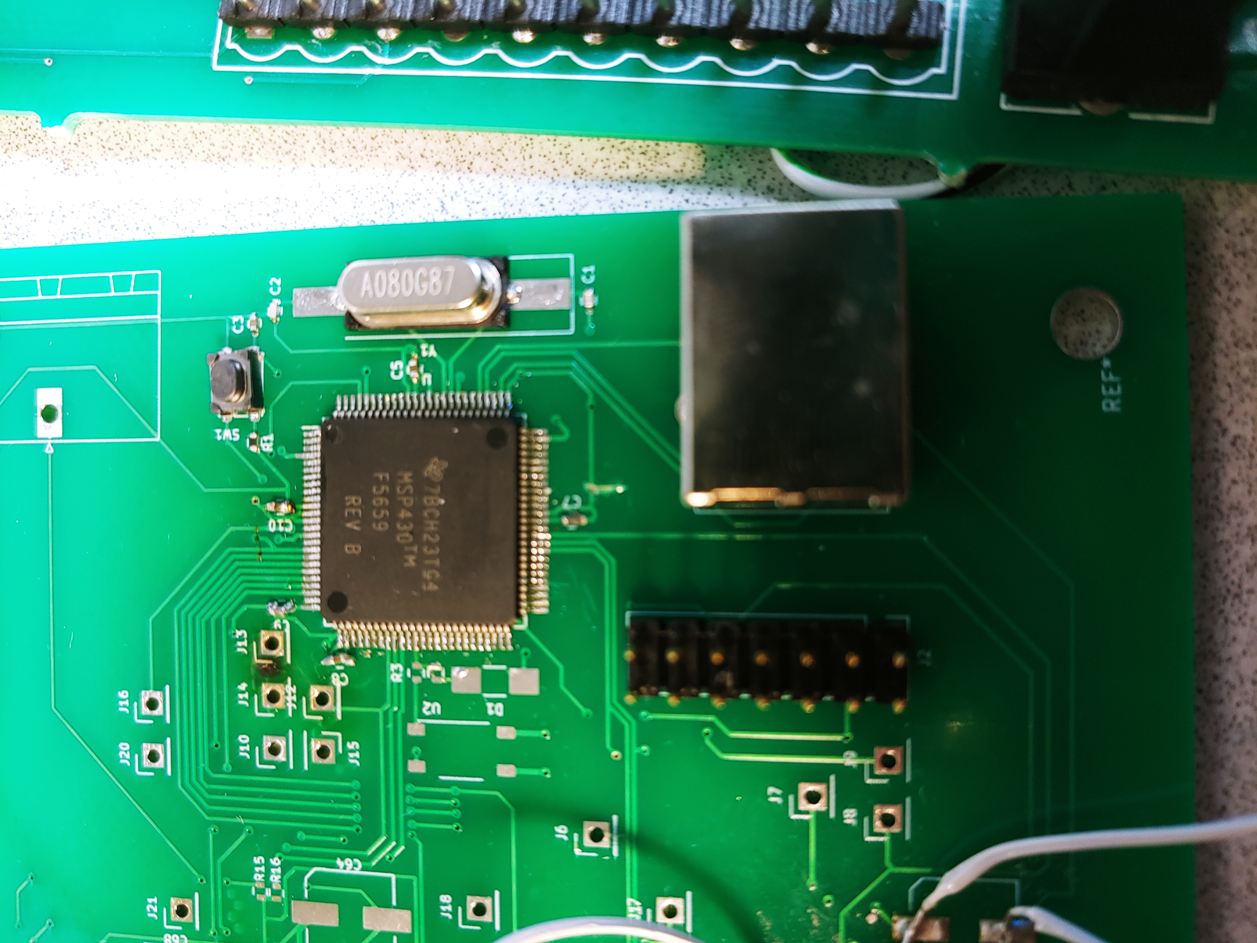

  • Matt,
    Here is a picture of both boards.
    Below is a picture of the board that does not work.
    Below is a picture of the board that does work.

  • Allan,
    Judging from the pictures you provided, the chip soldering on the board that does not work looks very different compared to the chip soldering on the board that does work. There may be signals that are not connected properly through the solder connections.
    I think the issue might be with the assembly of the board itself and not the device on the board. Are you able to try swapping the devices to see if the problem follows the device or to confirm that the problem stays with that specific board?
    Matt
  • Matt,
    I replaced the MCU on the board that does not work this morning. So I am pretty sure it must be the board traces. I will try and solder some wires to the pins of the MCU to see what kind of signals we get on JTAG.
    Allan
  • Allan,
    If the issue is in fact a problem with the manufacturing of your board then you may want to work with your board manufacturer to address this problem with the traces and/or assembly work.
