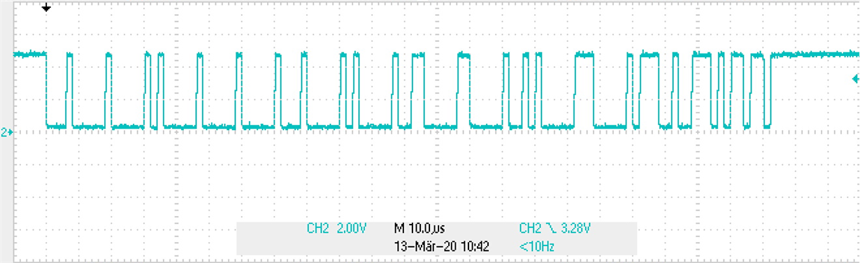

    i have done some more testing and measuring with an oscilloscope. It seems that the device has some problems with the bus timing when only sending once on an empty bus. There i measured only 2 - 3 small pikes, nothing else. After putting a loop around  "MAP_CANMessageSet" i can see the CAN frames on the scope. I think i'm good for now, this is something i can continue working with. Thanks.
    Christoph

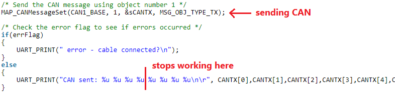

    for the CAN transmitting device the relevant code section is the following:
    /* Send the CAN message using object number 1 */
        UART_PRINT("sending CAN message...\n\r");
        MAP_CANMessageSet(CAN1_BASE, 1, &sCANTX, MSG_OBJ_TYPE_TX);
        /* Check the error flag to see if errors occurred */
        if(errFlag)
            UART_PRINT(" error - cable connected?\n");
        else
            UART_PRINT("CAN message sent successful: %u %u %u %u %u %u %u %u\n\r", CANTX[0],CANTX[1],CANTX[2],CANTX[3],CANTX[4],CANTX[5],CANTX[6],CANTX[7]);
    Debugging step by step, starting with line 2. Then it opens uart_term.c doing the following code:

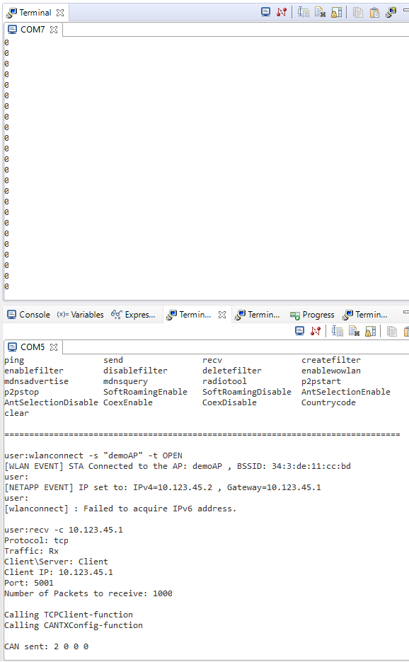

  • In found out that the "CAN1_IRQHandler" is not called, wether on the transmitting device nor on the receiving device after the CAN frame is sent. Is this because of the existing issue, or is it possible that this causes the issue?
  • Shall i open a new thread because it is already marked as "resolved"?
  • So what's the issue right now? UART PRINTF issue or CAN send/receive issue?
    We need test the CAN and UART PRINTF separately to narrow down the issue.
  • Hi Winter,
    the UARTPRINT in general works fine. Sending a CAN message is also working. I can see the valid CAN message on the sniffingtool i use. But after the CAN message is sent, the CAN-receiving device gets interrupted in the middle of its current UARTPRINT as you can see in the image below, and afterwards nothing else happens.
    Kind of the same thing on the sending device. After the CAN-message is sent it stops in the middle of the UARTPRINT directly after the CANMessageSet function. When i remove this UARTPRINT it also doesn't continue with the code much further.
    Terminal:
    I think the cause could be the CAN1_IRQHandler because this is what should be called on both devices after sending the CAN-message. But it isn't called. Maybe there is some Interrupt-configuration missing or something like that. I know that there is some interrupt-configuration in the "startup"-file in the CAN examples, but there is no such file in the network_terminal example.
    Christoph
