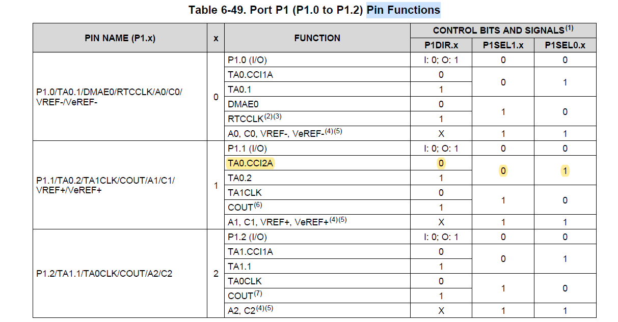

I found this statment about interrupt vector :
The name of the interrupt vector for TACCR1,TACCR2, and TAR is TIMER0_A1_VECTOR. All three
To detect whether it is TACCR1, TACCR2, or TAR that
and P1.1 is used as input capture setup pin 1.1/TA0.CCI2A as below table
let me know which interrupt vector should be used ?
TA0CCR0 is special -- it triggers TIMER0_A0_VECTOR and does not have to be explicitly cleared. All the others trigger TIMER0_A1_VECTOR and must be explicitly cleared. [Ref User Guide (SLAU367O) Sec 25.2.6]
TA0.CCI2A triggers TA0CCTL2:CCIFG.. TA0CCTL2:CCIFG triggers TIMER0_A1_VECTOR.
You've done all this correctly. The missing piece is that in the ISR you have to explicitly clear TA0CCTL2:CCIFG or it will keep triggering:
> TA0CCTL2 &= ~CCIFG; // Clear capture interrupt
