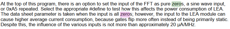

    • Regarding your comment about the current being proportional to the number of rowA, are you seeing different average current once LEA starts running? There is a portion of the function that is going to be "static" - initialization, parameter checks, etc- and another portion which should be variable and proportional to the number of cycles. In theory, once the loop starts running, the current should stay relatively stable in average, except for the next comment.
    • The current for LEA depends on the types of instructions executed and even the data. That's why the datasheet doesn't include just a spec for power consumption, but it shows different use cases (Table 5-14 of SLASE54C) .Table 5.10 also shows how the typical current for an FFT is 66uA/MHz when the data is zero, but 86uA/Mhz when the data is nonzero.

    The implementation doesn't really do that, it will do the multiplication nonetheless and it will take the same amount of time. The power will differ due to the actual data itself as explained in SLAA698:
    Luis R
  • Okay, I think I understand, different inputs should consume different energy, but the variance should be not more than 20uA/MHz. The zero input case should consume the lowest current, because of the gate-level behavior. Thank you
