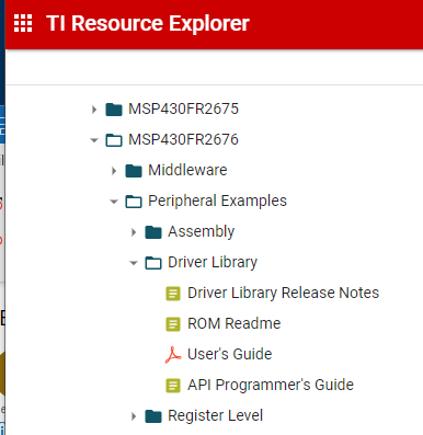

    At first though was like where did Gary find that code??
    • I knew I looked thru the TI Resource Explorer - None of the code examples used the DriverLib (but that was for my small part MSP430FR2676)
    • But then realized your link pointed to the MSP430FR4133 and DOES have DriverLib code examples (since probably more memory)
    • So all makes sense - thank you so much for pointing me in the right direction!!!
    Thank you Gary,
    Willie
    Pictures attached showing:
    • MSP430FR2676 doesn't have DriverLib Code Examples (very little memory)
    • MSP430FR4133 DOES have DriverLib Code Examples (more memory - so maybe worth it!)
