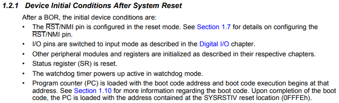

This post is a follow up on the related question with new information. All previously described behavior is still occurring, but I found that the source of the wild program counter is a bad value stored in SYSRSTIV located at 0xFFFE. The address stored at this location is loaded into the program counter right before the user program is started:
Using GDB we can see the difference between normal and erroneous operation:
Normal Operation

The code snippets show the location of interest (RESETVEC) and the surrounding instructions. Prior to running, 0xFFFE always appears to be correct when I print the memory location. It's only after attempting to run the program and it getting lost in garbage land that I can see it's 0xFFFF instead of the correct value 0xDCB4. I'm not sure if this is GDB reporting the wrong/old value or if it somehow gets clobbered. It's suspicious that it only happens on the first launch and never any subsequent loads.

    Notes:
    - The request/write sequence seems weird. GDB requests data to write starting at 0xfffe but then addr=oxfff0 in MSP430_Memory. GDB then requests data starting at 0x10000 but the following addr=0xfffe.
    - Also in the request/write sequence: GDB requests 0x8 bytes starting at 0x10000, but ends up writing 0xa bytes seemingly starting at 0xfffe. Could this be an alignment issue? If it is, I wouldn't expect it to work on subsequent loads
    - After the load command, the gdb agent shows that pc=0xffff and then issues a register write to set it to pc=0xdcb4. This does not happen on the initial load.
    Bonus note:
    I just found a very interesting behavior. On initial launch, the pc will be wild. After a subsequent load, the pc and the program will always run normally. However, multiple 'load' commands in a row without running the program in between will reproduce the wild pc.
