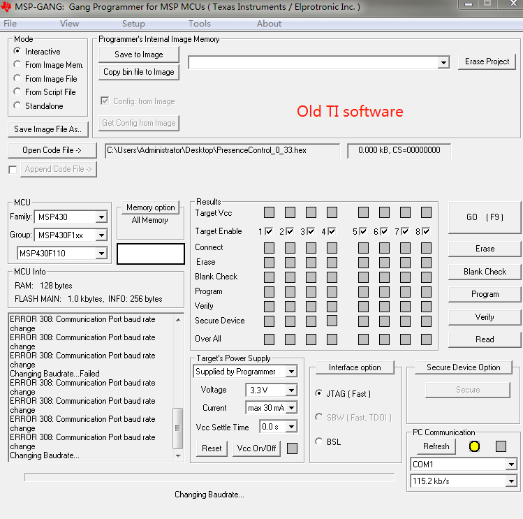

My customer is using GANG to program MSP430FR2633 and met below error prompt. please kindly suggest what may cause this ?thanks.

    Looking at your screenshot, I see you're trying to use UniFlash with the MSP-GANG programmer which isn't supported. Can you please try using the MSP-GANG GUI?

  • Dear James
    we used MSP-GANG Programmer to read the software sucessfully before. But our customer updated their product software, we found we can't read it via the
    the old TI software. It shows : 0k, CS 0000000. We have feedback this problem to them, and they replied we should use UniFlash version 5.10 from TI.
    But we found it also can't work.
    Do  MSP-GANG Programmer fit to read it?

  • Dear James
    I used MSP-GANG GUI, but it can detect the software. It prompted 0 K CS 000000

    By "old TI software", are you referring to the MSP-GANG GUI software? By "updated software", do you mean "UniFlash"? Please clarify. As mentioned above, UniFlash should not be used with MSP-GANG. Who recommended that to you?
    Please switch back to using MSP-GANG GUI software. However, I'm concerned that using UniFlash with the MSP-GANG may have affected the MSP-GANG's software.
