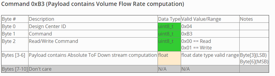

A) Command 0x97 (Request Delta ToF, Abs ToF and Volume Flow data)
1.
SEND command 0x97 to EVM:
2.
RECEIVE msg 0xB3 from EVM:
???-> how to convert payload now to measuring value???
Documentation says float data type Byte[3](LSB), Byte[6](MSB).
So is the float data:
3e-ec-c4-00 = 0.462432861 (float little endian DCBA) ?

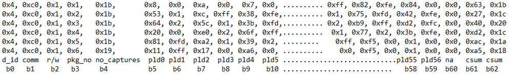

B) Command 0x98 (Request UPS and DNS captures)
SEND 'request command' to EVM:
RECEIVE 'start command' from EVM:
RECEIVE 'payload packages from EVM:
Documentation says int16_t (-32768,32767). So I guess two bytes = one int16_t. But which bytes to read first, and which one is MSB/LSB?
Do I start with package one, payload 0/payload1 and end with package 6 payload 55/56?
So in this case:
first adc capture value: 08-00 = 2048 (signed int big endian AB)
last adc capture value: 01-00 = 256 (signed int big endian AB) ?

    Regarding the data formats I am being told:
    MSP430 is a little-endian device. You can see that in the compiler settings:
    1. So you are correct with the float:
    Additional information at https://en.wikipedia.org/wiki/Endianness
    & for our reference, you can see https://www.binaryconvert.com/result_float.html?decimal=048046052054050052051050056054049
    1. With the 2nd one, I think it should be reversed.
    YES
    So in this case:
    Here it should be reversed. It is still little-endian. So
    08-00 is int16_t 0x0008 = 8
    01-00 is int16_t 0x0001 = 1
