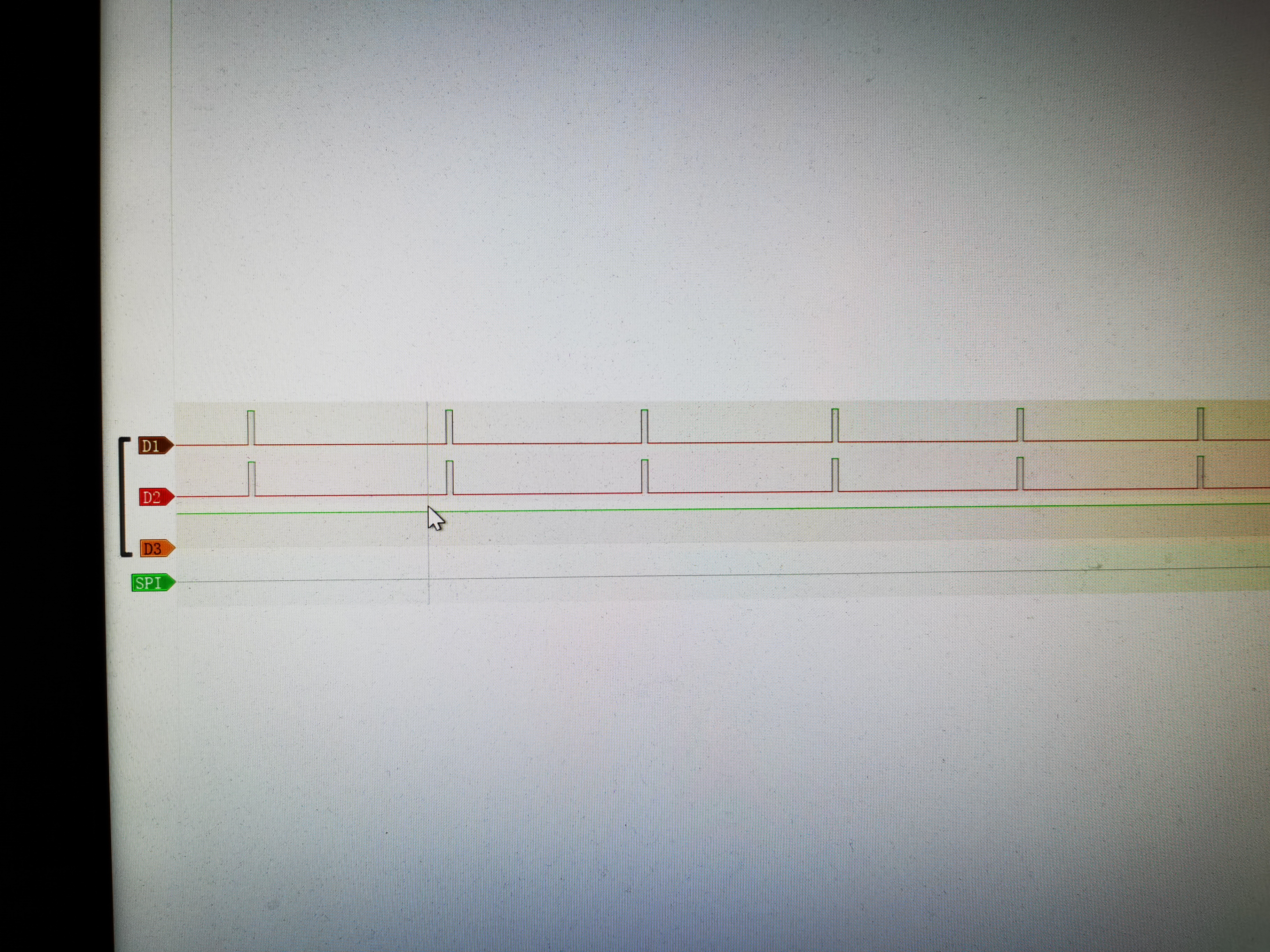

Hi, I am new to msp430 and now I have a problem using msp430 SPI interface.
I want to test the SPI interface, but after I connect the logic analyzer with msp, the SPI signal was not sent out. the CLK and MOSI stay low all the time. I am wondering if it is the problem with the board. if yes, how can I test it. I actually tried the sample code of SPI provided by TI, but it doesn't work either.
Following is my code. it will repeatedly send 0x00 and 0xc8.

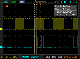

  • I don't see that symptom on my Launchpad, probing P3.0/P3.2. (The clock really is 32.8kHz, I just tried to fit too much on the screen.)
    I'm not sure what we're doing differently.
  • so this is my code running on your msp? if so, it should be the hardware problem
  • Yes, I just pasted what you posted and put it on my Launchpad (MSP-EXP430F5529LP, for the keyword searchers).
    What platform are you using? Are you fairly certain you're using the right test points?
  • I use the msp430f5529lp either, and yes I test the signal on Pin3.0 and 3.2. the other functionalities seem good. The GPIO pin1.3 was set to high successfully, but the SPI? No.

    Actually I noticed one thing while testing, at the very beginning of the main function. the sentence: "WDT_A_hold(WDT_A_BASE);". If I delete it, the signal will not stay low all the time, it will have very wired "up and down" behavior.
    D1 and D2 are the CLK and MOSI. this kind of "pulse" will not be affected by the SPICLK I set. I don't know if it is a normal situation.

  • The WDT thing I can explain -- the WDT is started automatically at Reset, so if you don't stop (or feed) it before it expires (32ms, I think) the MCU will reset (repeatedly). That's the pattern you saw.
    For the rest of the symptoms I don't have an explanation. If you have (or can get) a spare, that might be the fast path.Did this board ever work, i.e. did it just start malfunctioning?
