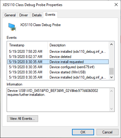

    Here's some more information form the Device Manager -> Events:
    The Information for each of the last four events:
    Device USB\VID_0451&PID_BEF3&MI_02\f&feb977d&0&0002 requires further installation.
    Device USB\VID_0451&PID_BEF3&MI_02\f&feb977d&0&0002 was configured.
    Driver Name: oem679.inf
    Class Guid: {8e84f6ae-7786-4c95-a48a-14cf3b92c002}
    Driver Date: 02/10/2020
    Driver Version: 2.0.0.2
    Driver Provider: Texas Instruments Incorporated
    Driver Section: USB_Install
    Driver Rank: 0xFF0001
    Matching Device Id: USB\VID_0451&PID_BEF3&MI_02
    Outranked Drivers:
    Device Updated: false
    Parent Device: USB\VID_0451&PID_BEF3\ME401023
    Device USB\VID_0451&PID_BEF3&MI_02\f&feb977d&0&0002 was started.
    Service: WinUSB
    Lower Filters:
    Upper Filters:
    Driver Management concluded the process to install driver xds110_debug.inf_amd64_c3db6584de66afb3 for Device Instance ID USB\VID_0451&PID_BEF3&MI_02\F&FEB977D&0&0002 with the following status: 0x0.
