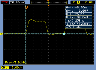

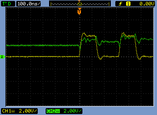

    I did some measurements from oscilloscope the see the signals Clock, CS and MISO (DOUT - ADE7753). As I attached here. I observed in ADE DOUT signal but his wave form don´t sound good. doesn't have an appearance like a wave bit form. yellow line CLOCK SIGNAL and green line ADE DOUT (MISO - MSP430 P1_6).

    CLOCK AND 1ADE7753 DOUT MEASUREMENTs
    To keep the clock value DIV4
    CLOCK SIGNAL (YELLOW) AND DOUT / MISO_P1_6 GREEN (FROM ADE7753 / MSP430)
  • The CLK signal looks adequate, but the MISO signal shows signs of bus conflict. If you're using a Launchpad: Did you remove the P1.6 (LED) jumper?
    Reading data sheet Fig 94, I'm pretty sure bytes are sent/received MSBFIRST.
    I suggest you try reading a register with a known (non-0) value. Maybe MODE (0x09)=0x000C or something.
