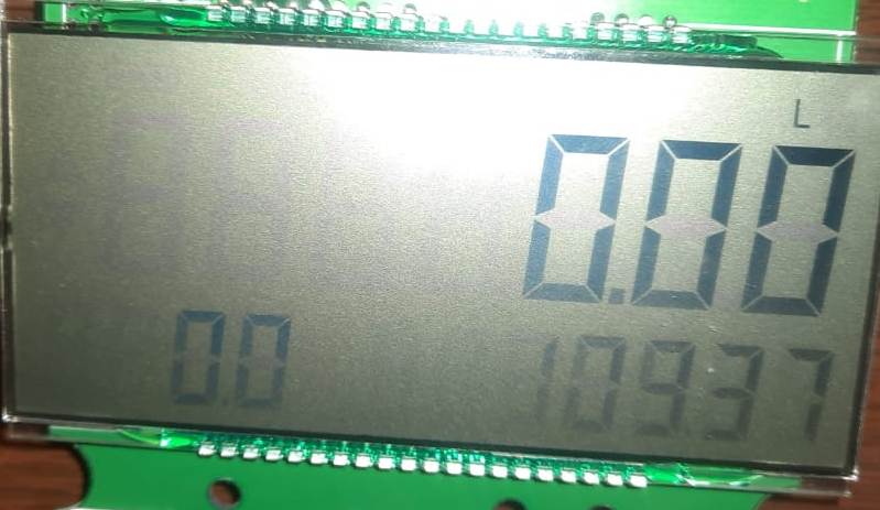

I want to interface MSP430F4152 with Segment LCD.Segment LCD is New for me .

From where i can download Segmented LCD Demo code like for below application with Digits , Symbols , Up an Down  etc.?
How do I write the waveform pattern in code/program  to display on Segmented LCD?

  • Is that photo your LCD? Do you have a data sheet for it and/or for the board it's mounted on?
    Generally, you drive the LCD by writing into LCDM1-LCDM20 (since they're consecutive, you can treat them as an array). But the bytes aren't ASCII, rather each bit corresponds to a segment. To know which one, you need a segment map, something like appnote (SLAA654A) Fig 13 (only larger). That would be in the LCD data sheet.
    The board data sheet would show how the COM pins are wired, and (implicitly) how the multiplexing works. I think there are a few conventions, but you need to figure out the particular one you have.

    Yes, This is photo of my LCD. But I don't have datsheet right now.
    I think you mean to say that the  data can be sent it to like traditional multiplxed seven segment .
    But How to do configuration for that lcd?
    Which mcu "register" should I right?
    Is there any demo program in 'C' in CCS for that?
    As In figure 13 of suggested application note, how only for
    4 Segment are used... COM1-COM4?

  • What code did you use to generate the display in the photo? Maybe that's a good start?
    User Guide (SLAU056L) Fig 26-2 shows the mapping from LCDM1 (ff) to pins Sx paired with COMy ("091h" is LCDM1). If your LCD is using COM0-COM3, a 4-mux example appears in User Guide Sec 26.2.9.
    Appnote Fig 13 is trying to show one example of (Sx,COMy) pairings which light up particular segments. I think the coloring is intended to make the segments easier to pick out in the diagram on the left.
    But Fig 13 only shows one digit; your data sheet should have a table showing the segments for all the digits. As an example, the MSP-EXP430FR4133 Launchpad UG (SLAU595A) describes its LCD screen and connections in Tables 3 and 4.
    It looks like TI doesn't make a MCU+LCD board with the F4152. What board are you using?
