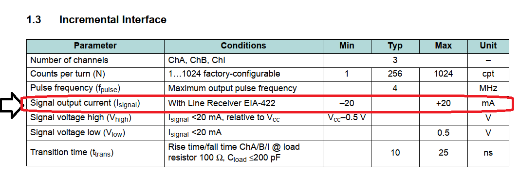

I have a device (encoder to measure the rotation velocity of motor shaft), in my application that works with RS422 protocol serial communication and TTL logic. I just need to receive data from the encoder and no transmission from MCU to the encoder is required. I have used EUSCIA3 to account for asynchronous communication. But it is not working. Can you please let me know if I am on the right direction and help me resolve the issue? and also what specifications (baud rate, etc.) are good for the EUSCIA3 given that my signal frequency is variable between 0 and 160kHZ. A snippet of the code is provided below for your review.
