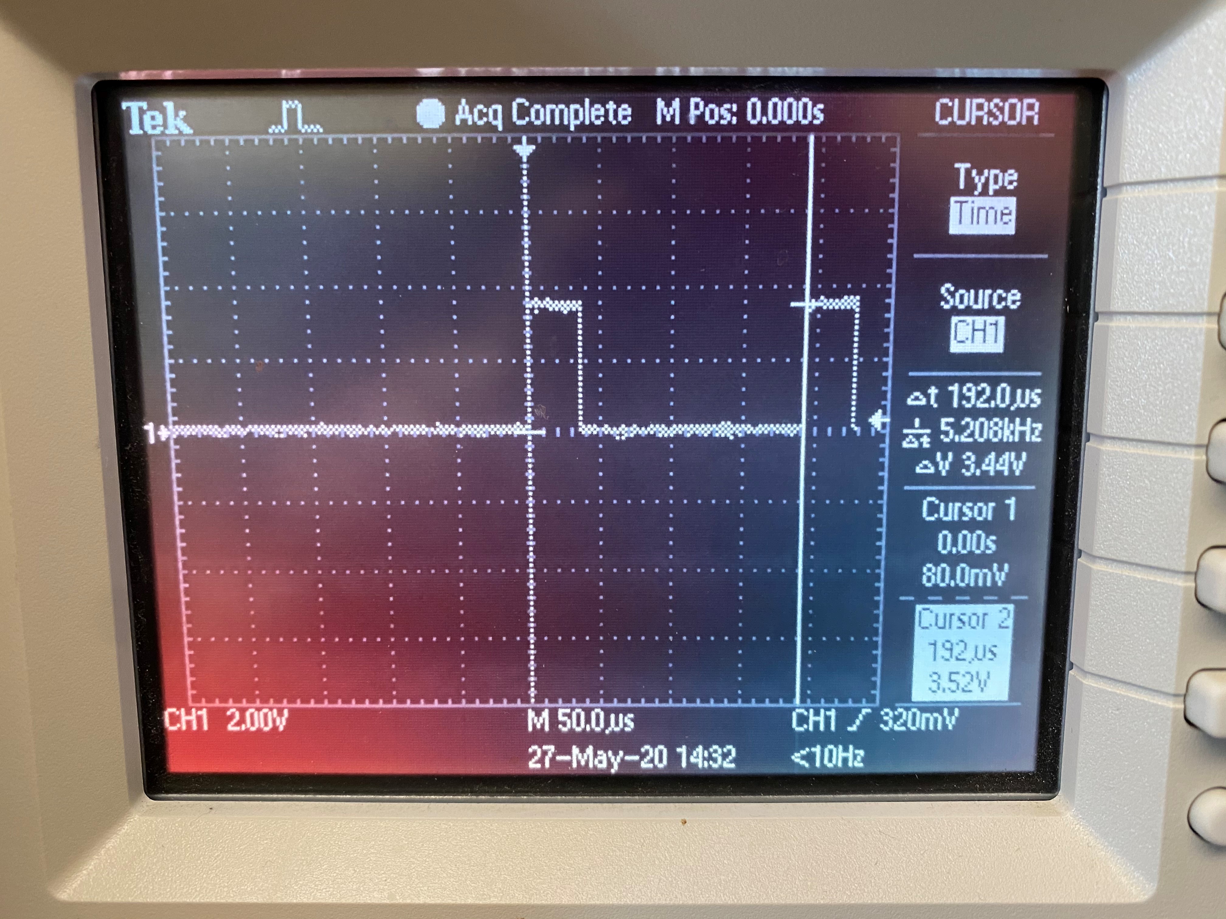

I am new to the MSP430 platform and I working on a project where a double pulse needs to generated with a 200us delay between both rising edges (see picture attached). I am currently trying to use Timer B to generate these signals. currently using standard 1MHz SMCLK for input to timer B.
The code below is what I currently have and I am not understanding how the TBxCCRn register are working. I was wondering if someone could help out? or provide a better explanation that the one that is the datasheet / family user manual? What is confusing me is the values that are being placed into the TB1CCR1 and TB1CCR2 registers
Thank you for all the help in advance.
#include <msp430.h>
int main(void)
WDTCTL = WDTPW | WDTHOLD; //stops the watchdog timer.
//Trigger Input (P1.0)
P1DIR &= ~BIT0;
P1REN |= BIT0; //enable internal pullup/pulldown resistors
P1OUT |= BIT0; // select pull-up mode for P1.0
P1IE |= BIT0; //enable interrupts
P1IES |= BIT0; //high -> low sets flag
P1IFG &= ~BIT0; //interrupt flag register cleared
//output on p1.1 (INIT_Q_DRIVE)
P1DIR |= BIT1; // setting direction on specific pin
P1OUT &= ~BIT1; // setting the initial output to 0
PM5CTL0 &= ~LOCKLPM5; //disable GPIO power-on default to activate previously configured settings
//TB1CCTL1 |= (OUTMOD_7 | CCIE); // Timer B1 Capture/Compare Control Register1 is set to Set/Reset
TB1CCTL1 |= CCIE; //Timer B1 Capture/Compare Control Register1 enabled for interrupts
//TB1CCTL2 |= (OUTMOD_7 | CCIE); // Timer B1 Capture/Compare Control Register1 is set to Set/Reset
TB1CCTL2 |= CCIE; //Timer B1 Capture/Compare Control Register1 enabled for interrupts
TB1CCR1 = 10;
TB1CCR2 = 20;
while(1){
__bis_SR_register(LPM3_bits | GIE); //enter low power mode and enable interrupts
// interrupt on I/O port (pin P1.0)
#pragma vector = PORT1_VECTOR
__interrupt void Port_1_ISR(void)
P1IE &= ~BIT0; //disable interrupts so none occur while in this routine
P1IFG &= ~BIT0; //clear interrupt flag that occured on p1.0
//below the different delay times need to be set (200, 400, 800, 1000 us)
//check input pins to see what has been selected. checked based on rotary switch
TB1CCR0 = 208; //200us delay (this hardcoding is temporary)
//start timer
TB1CTL = TBSSEL_2 | MC_1 | TBCLR | TBIE; // Starting the timer, SMCLK(1MHz), UP mode, clear TBR, enable interrupt
//timer b interrupt service routine when timer b causes an interrupt this is called
#pragma vector = TIMER1_B1_VECTOR
__interrupt void TIMER1_B1_ISR(void)
switch(__even_in_range(TB1IV,TB1IV_TBIFG))
case TB1IV_NONE:
break; // No interrupt
case TB1IV_TBCCR1:
P1OUT ^= BIT1; //Output...rising edge of both waves
break;
case TB1IV_TBCCR2:
P1OUT ^= BIT1; //Output...falling edge of both waves
break;
case TB1IV_TBIFG:
P1IE |= BIT0; //interrupt enabled
P1IFG &=~BIT0; //clear interrupt flag... when timer stops
TB1CTL = TBSSEL_2 | MC_0 | TBCLR | TBIE; //Stopping timer
break;
default:
break;
