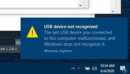

    When I plug in the Launchpad, first I see this in the corner, after about 10 seconds:

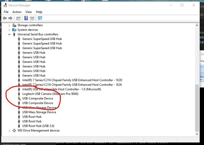

    Then in Device Manager, you see this:
    When you open up the device properties, the Device Status is "Windows has stopped this device because it has reported problems. (Code 43)".
