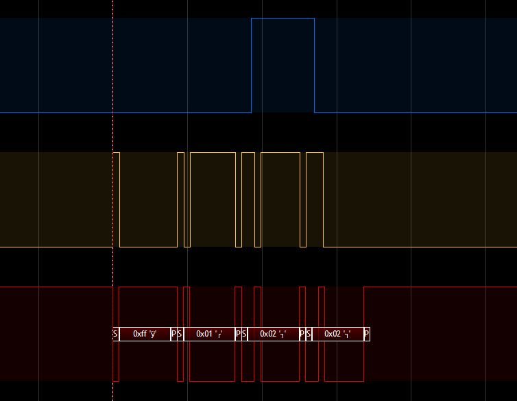

    As you suggested, I placed a "while (!(UCA1IFG & UCTXIFG));" loop just before the "RS485RX;". Now the RS485 signal, that passes thought the transceiver, is longer. But it seems, that the interrupt flag is released, when the last byte of the string has just started to be send, and not when this operation is finished.
    //Sending an rs485 command for test purpose
    {  RS485TX;                                                            //Set RS485 transceiver output Pins to TX
       unsigned int i;
       for (i=0;i<size;i++)
          {sendRS232(data[i]);}
       SET(P6OUT, 0x20);                                             //Set Port (blue line)
       CLEAR(P6OUT, 0x20);                                        //Clear Port (blue line)
       RS485RX;                                                              //Set RS485 transceiver output Pins to RX
    Blue: Duration of the "while (!(UCA1IFG & UCTXIFG));" loop
    Yellow: Signal that passes through the transceiver (A/B lines)
    Red: UART signal, that came from the micro controller (TX line)
    The oscilloscope shows that the "while (!(UCA1IFG & UCTXIFG));" released too early, before all the string sending is complete. And so the "RS485RX;" stopped the transceiver too early, while sending the last byte.
    Do you have an idea of what I could do to resolve this problem?
  • Of course checking just TXIFG is a problem. That gets set when TXBUF is empty, not when the shift register is empty. My check was in an ISR in response to another interrupt.
    For polled operation where you are absolutely certain that the receiver is idle, check UCBUSY.
  • Thanks a lot.
    With the check of "while( UCA1STATW & UCBUSY );", it works now.
