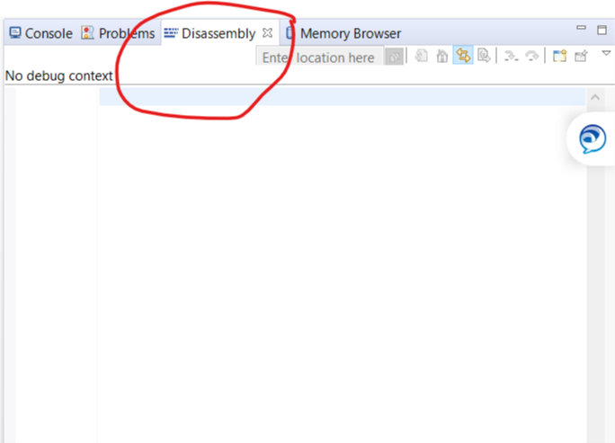

    It is not a XOR instruction.
    It is
        while(1){
            P1OUT ^=BIT0;
    First, arm will take more cycles to run an instruction than MSP430.
    Second, it includes a while loop besides XOR instruction.
    Third, It is a C language, not assembly code.
    My advice is that you can see the assembly code under debug mode:

    True, I skipped the WHILE (1) loop, and was confused, thinking as if the ARM were executing the instructions just like the MSP430.
    I also didn't know that I could see the code in assembler, that was very helpful, I checked the Cortex-M4F datasheet to see the clock cycles needed to execute each instruction shown in DISSASEMBLY window (corresponding to WHILE cycle and P1OUT ^ = BIT0), and indeed, the total cycles necessary to execute those instructions approximately coincided with the generated frequency.
    Thanks, I was a little confused.

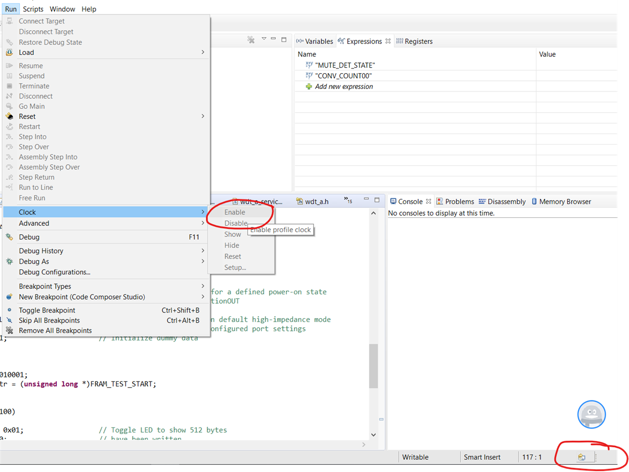

    But MSP430x5xx/6xx (without FRAM wait states) port write will take 2 cycles, xor 1 cycle, and write back 3 cycles. That is total of 6 CPU cycles without loop.
  • Add one way to count the cycle, you can enable the clock and can see the CPU cycles used in the CCS.
