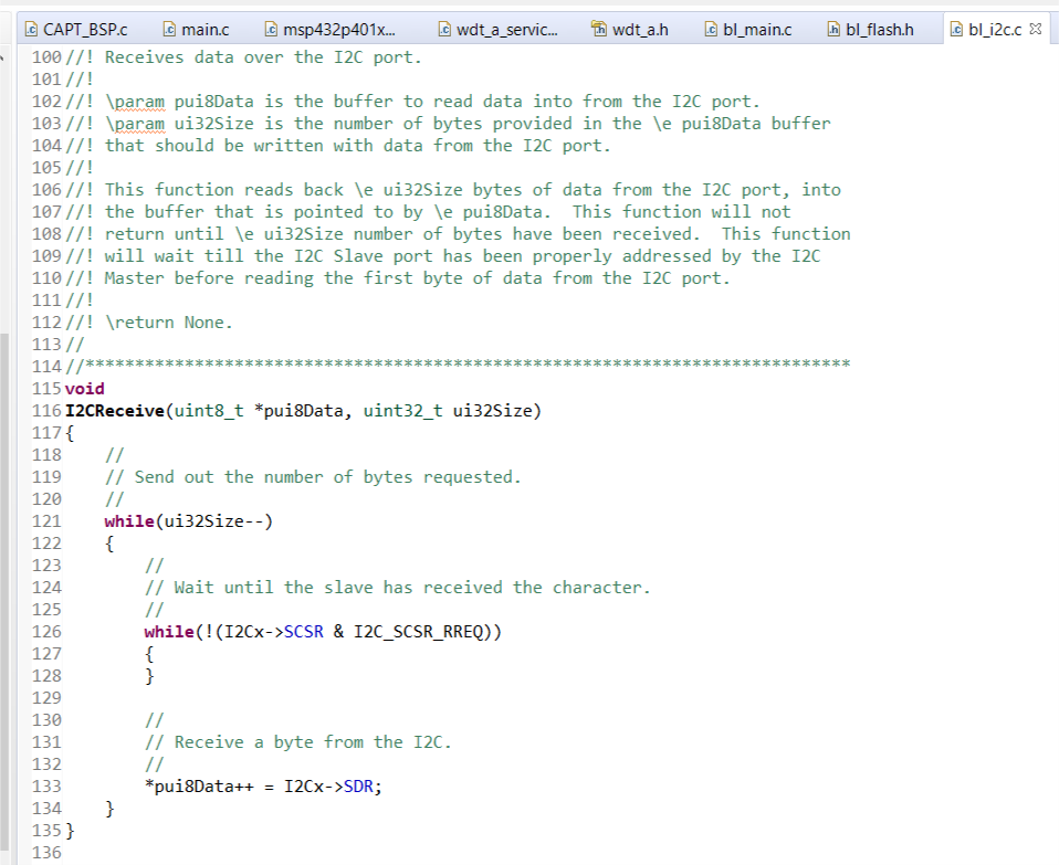

    This is from MPS432Pxx, which is same with MSP430, it shows that it support this function.
    I must say it should meet the I2C standard and support this function. I can't find any code examples, one solution is to refer to bootloader(C:\ti\simplelink_msp432e4_sdk_4_10_00_13\examples\nortos\MSP_EXP432E401Y\boot_loader). Or you can look into the API user guide.
