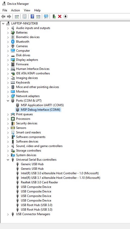

    It does sound like an issue related to the PC, possibly either the USB port or the driver.  Can you try a different port?  how does the EZ-FET present in your device manager?

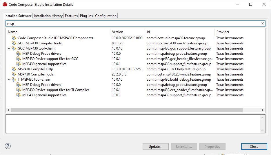

    Can you also share your MSP430 tool driver versions from CCS?  (Go to help -> About CCS:  Click on installation details and search "msp"     Attach a screenshot so we can see what is installed.)

    To answer your question for 10.0 Below is the screen capture of the versions and window device manager. I am running on Windows 10.
