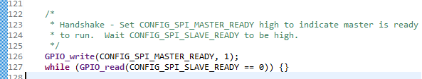

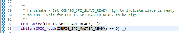

The issue that I am having is with the following line:
And then I have the same problem with the corresponding line on the slave side

The while loop just gets completely blown through. I have tested it a number of different ways and this is the best explanation of what I've found.
If I hook up the each of the MSP to one another, the while loop gets blown through.
If I leave one MSP sitting with no connections whatsoever, the while loop gets blown through.
If I am probing the CONFIG_SPI_MASTER_READY or CONFIG_SPI_SLAVE_READY (depending on which board I am testing) AND I do not connect the board I am testing to anything else, it is sitting with no connections whatever, it will wait at the while loop as it should.
As mentioned above, I have not altered the code from the examples provided in the TI Resource Explorer in any way.
This is a very strange problem and I'm completely at a loss as to what may be causing it. I have tested this issue on multiple MSP units and it remains consistent. Any help would be appreciated.

    The problematic code master side.
    The problematic code slave side.

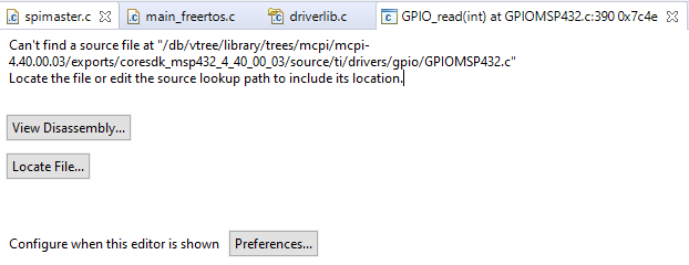

    Since my post yesterday I have uncovered something new that I suspect may be the issue. Sometimes when I pause the program while debugging, I get the following dialogue window.
    I don't know what this filepath is, it doesn't match anything on my computer and I do not (to my knowledge) have this GPIOMSP432.c file. It would make sense that missing this file would cause the issues I'm seeing, I think.

  • Typo Alert:
    > while (GPIO_Read (CONFIG_SPI_SLAVE_READY == 0)) {}  // (I hope I typed that right)
    Try:
    > while (GPIO_Read (CONFIG_SPI_SLAVE_READY) == 0) {}  //
    In my copy of spimaster.c, this is what line 124 looks like.
  • That was my mistake, I had to throw those two lines in. I changed them a bit while trying to debug and had to throw them back in to retake the screenshots. I didn't run the code with that error present
