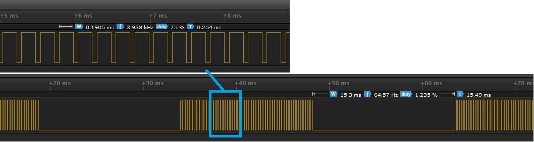

  • With this code I receive the output pictured below.
    4kHz frequency and 75% duty cycle - which is what I expected.
    But why is there a 15+ms break between activity? As if the PWM itself works on a 50% duty cycle.
  • I figured this out - the gap was because the code linked to SMCLK (TASSEL_2) - and when I linked to TACLK (TASSEL_0), there isn't a gap.
    But if I'm linked to any other clock - I can only get 50% duty cycle.
    I'm going back to SMCLK - so that I can change the kHz frequency and the duty cycle.
    Again - why are there the gaps?

    Changing the CCR is routine. The TimerA CCRs aren't buffered, so the effect is immediate. This can cause glitches depending on the momentary state of the counter (TA0R). For a fast PWM, and a slow device (heater as LPF), these glitches probably don't matter to you.
    Going into LPM0 does not disable interrupts, nor does it enable them. If you've enabled interrupts (GIE) elsewhere I don't know what would cause your symptom.
    LPM does affect the program flow, in that main() halts at that point until explicitly awakened. (Do Not use LPM in an ISR.)
    I don't see anything in the code you've presented that would cause that PWM pause. I suspect the cause is in some other code (not shown).

  • It really sounds like some other part of your system is interfering with you, and going into LPM right then prevents that other part from running (and getting in the way).
    Prime suspects would be anything that messes with the (a) TA0 or (b) P1SEL/P1DIR configuration.
    [Edit: Messing with P1DIR could cause trouble as well.]
  • Thanks Bruce.
    You're right - I thought of this also after work yesterday - and there is something that's interfering with the clock.
    I changed the main clock to TB0 and now the device is working with the heater.
    Mechi
