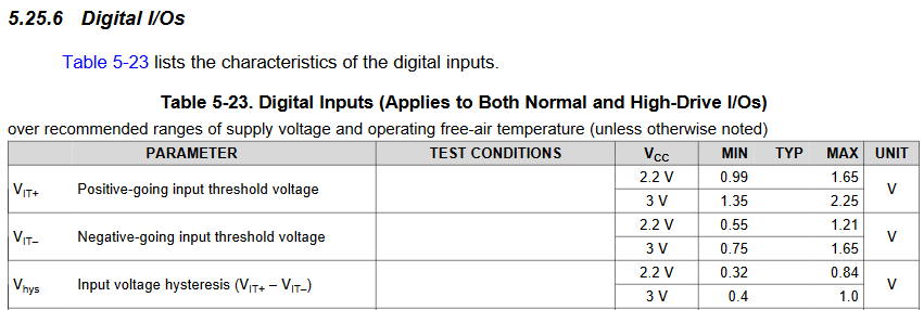

Please help me to get the Voh(min),Vih(min),Vol(max) and Vil(max) values for I2C lines(SDA and SCL).
  • Hello Anoop,
    From the datasheet, for VIH and VIL see:

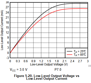

    For the VOH and VOL, since I2C bus is an "open-collector" drive scheme, the IO port pin does not actively drive the pin high, it is pulled up to VCC using resistors.
    VOL should be considered though.  As you can see from the graph, VOL will vary with the current flowing through the pin.  That is calculated by VCC/R, where R is the pullup resistance.   Example 3.3/10k = 330uA.
    Now looking at the graph, 330uA would produce a very small voltage drop, well below the VIL input threshold of the other devices on the bus, such as another MSP432 (From chart above, min is 0.55v).
    Does this answer your questions?

  • Understood about Voh and Vol values. We are powering MSP432 with 3.3V supply. What will be the values of Vih(min) and Vil(max)? Can you explain little bit in detail?
  • Hi Anoop,
    The values will be ratio metric.
    Going from 3.0v to 3.3v is a 10% increase, so you would increase the VIH and VIL by 10%
    Example: from the chart above, let's take VIT+ max which 2.35v when VCC = 3.0v.
    Using this formula you can calculate what VIT+ would be at 3.3v
