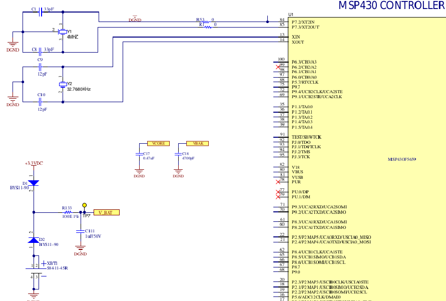

From above sample code we observed RTC continuous update even after supply removed to controller.
That is RTC operation working properly even after controller power off.
The above reference test code has application with low power mode scenario.
As in our product application always be in normal power.
Then we tried with some following changes in reference test:
while(1)
//__bis_SR_register(LPM3_bits + GIE);
__bis_SR_register(GIE);
__no_operation();
Where we disabled low power mode entry and enabled only global interrupt.
With above changes we observed that, After controller power OFF RTC time values are not being updated, As on power ON observed same RTC time values as same before power OFF.
As per reference to https://www.ti.com/lit/an/slaa665b/slaa665b.pdf:
  • On Reset LOCKBAK after RTC configuration, RTC values should operate normally even there is no Vcc or LMPx.5 mode.
After above exercise, it seems to be that after controller power OFF RTC time values getting updated, only if controller was in LPM3.
Please do suggest us if anything missing from our end.

    I test this issue you described, and the result show that the RTC function is normal.
    Some note need to be attention:
    When you disable LPM3 mode, The while(1) program will continue to run, which may be the cause of the problem, so you need to move the program in while(1) to the interrupt service routine,
    Attach my test code :

    - Below is schematic for RTC which we are using for our custom board.
    Please do kindly share your comments on above schematic, if we are missing anything.
    Satyanarayan G.
    I used the F6638 device described in the slaa665b.pdf document for my test, but it seems that the test results should also apply to F5659.
    I took a look at your schematic, it looks normal, you can test it to see if it can solve your problem.
