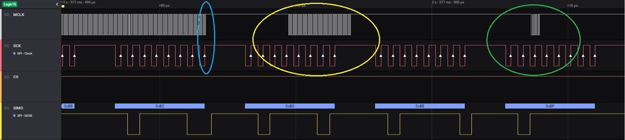

The following picture (PICTURE1) is a capture of the SPI reception (SCK and SOMI signals) attended by DMA module as short MCLK signal bursts (0.625us width) approx. 5us after the 8th risig edge of SCK, that overlaps with execution of the main routine attending Timer A0.0 interrupt and returning to LPM3 (TRACE1 signal).
PICTURE1: https://drive.google.com/file/d/1_sZtCb4t-Eim0TyWaygotPmCtsETUFln/view?usp=sharing

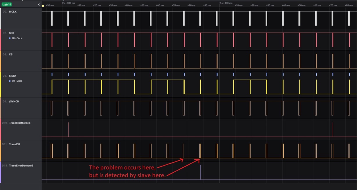

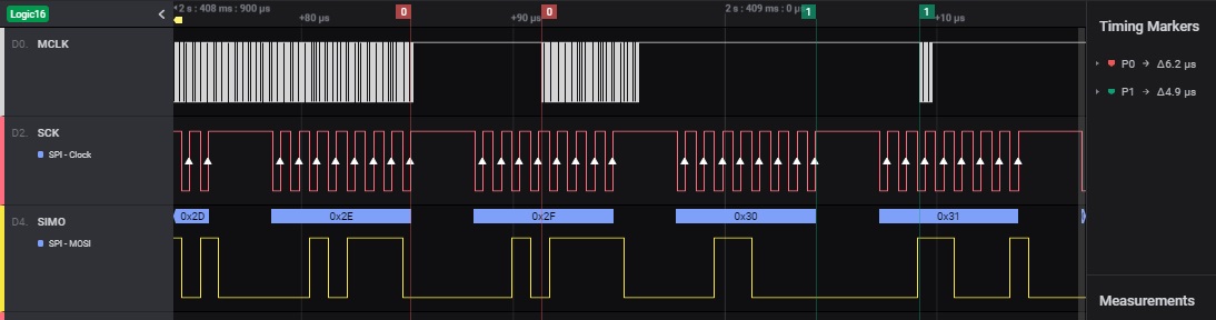

Next picture (PICTURE2) is a zoom of same capture with timing markers in the capture region where I want to focus.
Timing markers 0 (red) and 1 (green) measure the 5us delay from SPI RX trigger to DMA transfer.

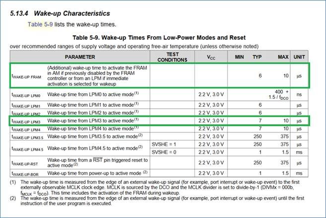

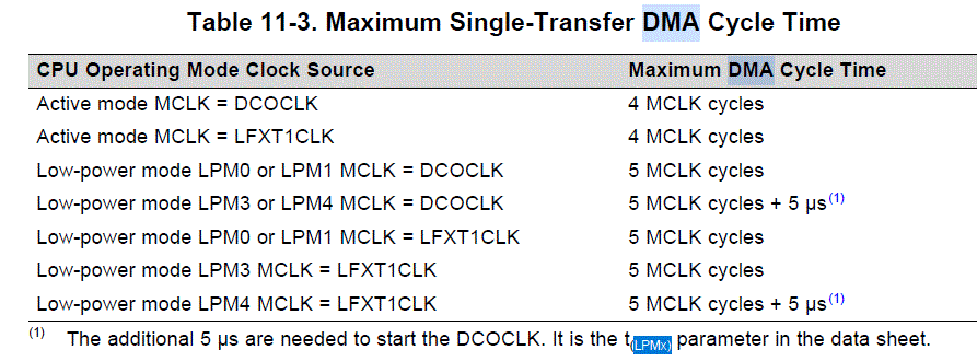

This 5us delay I understand is the one described in MSP430FR59xx User´s Guide (SLAU367P) section "11.2.7 DMA Transfer Cycle Time", to turn on and sincronize with DCO.
PICTURE2: https://drive.google.com/file/d/1qc81qf2zQKgUprw3TGEE1_1P66BQA4Rj/view?usp=sharing

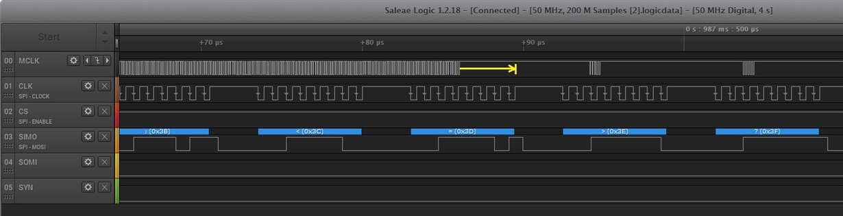

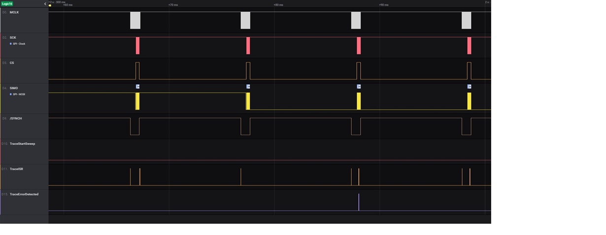

The problem I´m having occurs when main routine returns to LPM3 just when the SPI RX trigger occurs (8th SPI clock) as ilustrated in next picture (PICTURE3, larger zoom of PICTURE2).
PICTURE3: https://drive.google.com/file/d/1YpIOWE4wpv1D9PGfRybSAZWmq4q9fduA/view?usp=sharing
The MCLK signal becomes active for approx. 5us or 6us (timing marker 3, orange) for DMA transfer of 2 received bytes (the pending 0x9A byte and the just arrived 0x9B byte), while a single byte transfer takes 0.625us (see timing marker 2, purple).
The problem is that many times this scenario is observed, inspecting the RAM buffer (DMA destination), the 2 bytes transfered bytes by DMA, have the value of the latter one, 0x9B in this case.
The processing of the RAM buffer (destination of DMA), confirms that the position for byte 0x9A has the 0x9B value, and position of byte 0x9B has 0x9B value as expected (the status message issued for this test was forced to a incremental sequence to aid in problem detection at the slave microcontroller).
As the 0x9B value is present in UCB0RXBUF by the time of the 8th SCK rising edge, I conclude that the 2 DMA transfers occur by the end of the 5us/6us burst of MCLK (timing marker 3, orange).
In some cases, when inspecting the RAM buffer, the byte sequence buffered is shifted as if it had lost the 0x9A trigger: it doesn´t contain the byte 0x9A and the 0x9B byte is not repeated, seems like the 0x9B byte trigger for DMA has overriden the 0x9A byte pending trigger.

 Could you confirm that the 5us delay described in section 11.2.7 correspond to the one observed by timing markers 0 (red) and 1 (green) ?

  • Picture 2 looks like an Rx overrun, which matches with your other symptoms. By simple (bad) luck,  Rx byte (N) completed just as MCLK shut down, and by the time it started up again Rx byte (N+1) had already completed. That first MCLK burst does look rather long, but I'm not sure it's outside the spec.
    On the Tx side, the SPI has 2 bytes of buffering (TXBUF+shift register). On the Rx side it only has 1.875 bytes of buffering, since when the final bit is shifted in the byte is immediately forwarded to the RXBUF.
    I've never looked, but I wouldn't be surprised if MCLK does a few more cycles after the CPU has "committed" to CPUOFF, so it's hard to tell exactly when the LPM3 started (was requested).
    SPI has no flow control, so the slave is subject to the whims (timing) of the master. The two obvious solutions/workarounds would be (1) LPM0 (<1us startup) (2) introduce an artificial delay between bytes in the master.
  • A slower SPI clock would do the trick too.

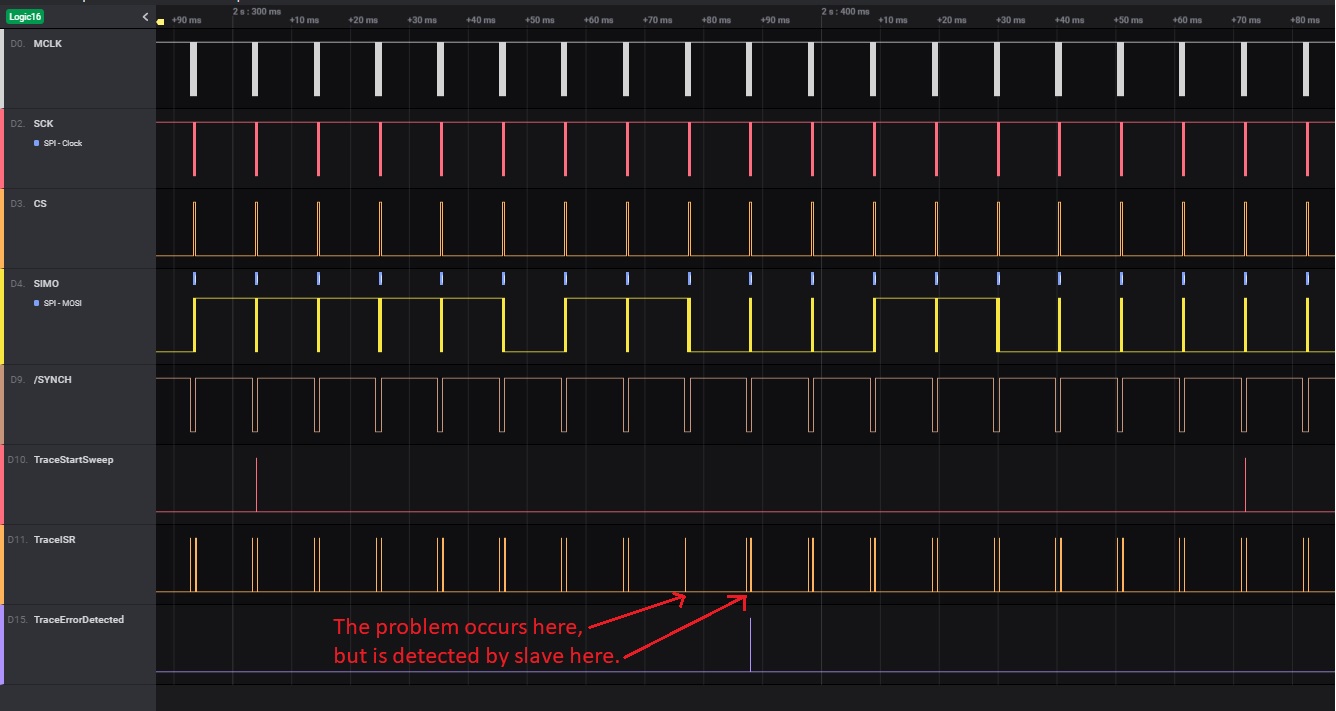

    Some trace signals were defined in slave microcontroller to trigger the capture in the logic analyzer and identify a failing scenario.
    Also a trace was added to each ISR routine to confirm that the delay does not correspond to an interrupt delaying DMA, something already supposed but not explicitly confirmed up to the moment.
    With this SPI frequency change, the problem presents most of the times as an overrun condition and a received byte is lost, so DMA transfer finishes when receiving first byte of the following packet, then triggers the processing of buffer and the error is detected.
    So, when the TraceErrorDetected signal makes a pulse during a packet reception, the delay and race condition most probably occured in the previous packet transmission.
    Focusing on the strange nop sequence (0 to 3) required to be adjusted to trigger the problem, we have found that when making minor changes in the code (like removing routines not used, or adding traces and adjusting execution to make coincide an SPI 8bit arrival with entering to LPM3) and the problem disappeared, we just only had to adjust again the amount of nops (0 to 3) of this sequence to make it happenning again.

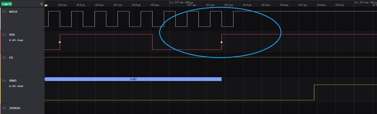

  • Hi Gary,
    You are very close to reproduce it, we now need to help synchronize events as ilustrated by the yellow arrow:
    We have to add a 4us delay approx. in slave microcontroller before the swtich that implements a sweep. If you look at source code, it could be added by changing DelayUs(650) to DelayUs(654), or by introducing nops (approx. 32 nops) in the already present nops sequence:
      // Dummy execution from NotSYNCH signal to overlap with SPI communication
      DelayUs( 650 );
    // Placing nops here to help the race condition which triggers the problem (*) to occur in about the middle of the sweep.
    // If any change in code or ISRs is done, the dummy execution duration may vary, so tunning may be required.
    // (*): Entering to LPM3 while the 8th bit of a SPI byte has arrived and triggers DMA.
      nop10(); nop10(); nop10();
      nop(); nop(); nop(); nop(); nop(); nop(); nop(); nop(); nop(); nop(); nop();
    I measured that 4us would be needed to let the middle case of the sweep to align with the 8th bit (as indicated by yellow arrow in previous picture).
    You can add to the analizer the TraceStartSweep signal at P5.0 of slave. It is a simple pulse indicating the cycle running the first case of the sweep. So you can tune the alignment to occur for a test cycle in middle of 2 pulses of this trace, and this is where the problem would most probably be observed.
    Another useful trace signal is TraceErrorDetected (P2.1) which marks that the problem occured and a byte transmission was lost by DMA. This trace shall appear in a cycle where the byte loss is detected, but the byte loss ocurred in previous cycle:
    If the problem occurs, the DMA losses a byte transfer, and it doesn't complete the configured transfer size until reception of first byte of the following test cycle. This is also observed in the TraceISR pattern (P5.1) because DMA ISR doesn't occur in the cycle where problem occurs:
    So, you can assist with TraceErrorDetected signal (P2.1) to check if you reached the problem conditions.
    Once the entrance to LPM3 and 8th SPI clock are aligned, it may still not be enough to be in the conditions which trigger the problem. If TraceErrorDetected signal pulse is not observed, you probably have to add 1, 2 or 3 nops (or (un)comment the nops already placed in code after calling InitPeipherals routine, highlighted here in green):

    In the cycle where the problem occurs, you would see a MCLK pattern like the yellow elipse in next picutre, instead of the expected MCLK pattern for DMA activity as in the green elipse. (0xBE byte is transfered at DMA activity in green elipse, 0xBD is transfered at the end of MCLK burst of yellow elipse, and 0xBC byte is lost by DMA due to the unexpected delay and overriden by 0xBD byte arrival).
    The cyan elipse is zoomed in next picture to illustrate the particular algnation observed where this problem occurs.
    Every time I observe the problem, the algnation beween MCLK and the 8th SPI clock is observed like this:
    Hope these indications are accurate for the 2 remaining fine adjustments you need in your setup to observe the problem.
    Please let me know if you reach or not the problem conditions.

    This just add about 4 us between two bytes send(13.5us total) and the issue seems not happened again
    https://e2e.ti.com/cfs-file/__key/communityserver-discussions-components-files/166/40-MHz_2C00_-200-M-Samples-_5B00_17_5D00_.logicdata
    It is not in larger time (>20us) have you test the workaround before?
  • Yes,
    As an emergency workaround, I have already requested to add in master microcontroller a delay between bytes, because we are deliverying protoptype units to the customer and the problem caused by this issue has presented many times. I proposed the addition of 8us to be far enough according to the observed cases.
    My concern is that I need to assert that such a delay is safe for any case, and if we don't understand what is the cause, we can't grant it will always behave in this way, maybe it varies across parts, or changes in temperature or voltage, maybe it is related to certain configuration used or to an errata already identified but with different symptoms. Do you follow me?
    Juan Andres
  • Hi Juan
    I think the most likely reason is that the wake up time from LPM3 to active. You know the DMA is using the MCLK that is the active mode with CPU off.
    That means the time interval should large than 10us. You can see your problem waves the time interval is about 8.8us that is not enough for MSP430 to wakeup form LPM3
    Best regards
    Gary

    I have already considered that information from slas789d and also the note (1):
    Datasheet
    And here the identified delay is having MCLK already oscillating. The wakeup time you refer I understand is the one between the 8th SPI clock event and the MCLK start oscillating as tagged with P0 and P1 markers in following picture:
    Such delay seems be predominated by FRAM activation time during wakeup, which it is stated as included in ( t WAKE-UP LPM3 ).
    Is note (1) incorrect?
    Juan Andres
  • Hi Juan
    I have also find some parameters in the user's guide
    That seems we just need about 5 us to wait the MCLK setup.
    But it seems more likely that this issue happen when the CPU going into LPM3 at the same time a DMA request appearing. For the picture you send above you will miss the byte "0x2F" right?
    Best regards
    Gary
  • Hi Gary,
    I disagree, I think the 5 us mentioned in Table 11-3 (slau367) are those seen before MCLK starts oscillating, like the interval tagged by P1 markers in the last picture posted, from the trigger event to the time MCLK is ready.
    Then as stated in section 11.2.7 (slau367) it takes 5 MCLK cycles to complete synchonization and transfer. Those 5 cycles are observed in the logic analyzer captures when DMA transfers occur during LPM3 intervals.
    By the way, I didn't find any symbol starting with tLPM in datasheet slas789, does this reference intend to point to tWAKE-UP LPMx ?  If that is the referenced symbol, such time occurs before the MCLK starts oscillating as explained by note (1) (slas789, Table 5-9, page copied in previous post).
    In the picture of previous post, the missed byte is 0x2E. When byte 0x2F is arriving, the DMA transfer of 0x2E is still pending. The extra MCLK cycles observed delay such transfer so much that 8th bit reception of byte 0x2F occurs first, overrides the RX flag, and when DMA finally takes place it only process a single flag, and transfers the contents of RXBUF: 0x2F. Hence, byte 0x2E was missed.
    Also, do you have any idea about the execution alignation caused by the 0 to 3 nops added at the begining of main to force the problem disappear or reapper depending the amount of nops, and that once the problem is present it persists if adding only a multiple of 4 nops?
    Juan Andres.

  • Hi Juan
    After discuss with our team we have found the root cause here:
    1. The code is using the PMM29 workaround of delayed FRAM wake-up to prevent PMM29 ERRATA à clearing FRLPMPWR in GCCTL0
    à with this the wake-up time is extended to twakeLPM3 + twakeFRAM which means 10us max + 10 us max means 20us
    2. Due to the PMM29 workaround the wake-up takes longer because FRAM LDO needs to be started now à therefore we have the additional MCLK cycles because Core LDO is up but Core not released because waiting on FRAM LDO.
    3. Due to the extended wait time of max 20us (~13us typical) the next SPI byte already received (within 10us) and therefore the RXBUFFER is filled with new data before the old one can be transferred by DMA.
    Best regards
    Gary
  • Hi Gary,
    So, do we have to consider a max of 20us (~13us typical) wake-up time even when DMA transfer does not involve FRAM as source address?
    I thought FRAM would not be required to be powered up for DMA transfer as source and destination where RAM addresses. And that FRAM would be powered up when wakeup cause was an ISR execution.
    Regarding your observation (t wake-up workaround) and my understanting that FRAM is not required for DMA in this case, it seems like the RX IFG arrival just when entering LPM3, is causing a FRAM power up in the following wake up for DMA. Therefore, the normal DMA delay from RX IFG while device is in LPM3 is  ~7 us typical (t wake-up LPM3) and if this unexpected FRAM power up occurs, then the delay increases to ~13 us typical ( + t wake-up FRAM), as observed in the captures.
    I will take the 20us time as worst case of wake-up for the workaround of adding a delay between bytes in master microcontroller.
    Juan Andres.
  • Hi Juan,
    correct, please consider 20us worst case wake-up time between the data transfers.
    And correct depending when the RX IFG arrival happens it can be that the first DMA transfer triggers FRAM wake-up. This is because we accept RX IFG DMA triggers all the time but the has different ways to handle it depending when the DMA trigger happens. However functional wise everything is as expected.
