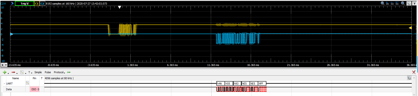

CCS/MSP430FR6989: The last byte of data that I transmit never sends.
Part Number: MSP430FR6989
I have implemented automatic baudrate detection on my MSP430. It is working as expected however when I go from reading in the synch frame to transmitting data, the last byte of data that I send never transmits and the byte before that is also sent as a 0xFF.
Something I noticed was that when I enter debug mode everything sends perfectly, however when I just flash my program onto the MSP430 and use an oscilloscope it doesn't send the right data.
Here is my oscilloscope reading:
Here is the code that I write:

  • I have never tried using the auto baud rate detection system but I suspect that your problem is in that code.
  • Before using auto baud rate everything was sending correctly. The weird thing is that debugging makes the code work, and it doesn't matter if I use the CRC function or the regular send data function, my last byte of data never sends and the byte before it always turns into an 0xFF. My guess is that there is something wrong with the timing since the debug allows more time for the code to send, but the send data function works fine for all the other bytes of data.
  • "Before using auto baud rate everything was sending correctly."
    Which should be a big hint that the autobaud code is the source of the problem. Post it and maybe I will see something obvious.

  • As near as I can tell, after measuring the baud rate (state=0) you leave the UART in autobaud mode (state=1) and overwrite the just measured values for the bit rate.
    The documentation doesn't say much about the effect on the transmit side while autobaud is enabled but what it does say tells me it should not be enabled unless you are actively trying to determine the baud rate.
    Oh, explicitly clearing RXIFG isn't required since reading RXBUF does that automatically.
  • That is definitely a good catch, I shouldn't be rewriting the baud rate and I'm pretty sure I can turn automatic baud rate detect off. But I was essentially trying to turn off dormant mode so that I could read normally.
    Is there a better way to turn UCDORM off without having to reset the entire register.
    I also took it out of automatic baud rate detect mode.

  • Clearing UCDORM is simple since it can be done at any time. Just use "UCA0CTLW0 &= ~UCDORM;"
    Exiting auto baud mode must be done with the UART in reset though.
  • Does clearing the UCABDEN in the UCAxABCTL register require a UART reset?
  • Ok I got it to work finally, I removed the UART setting from the while loop and I just set and reset the UCDORM in the loop essentially. Let me know if you want me to post the working code.
