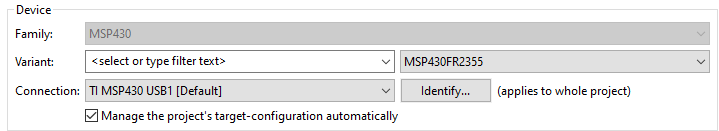

    If I select a target of MSP430FR2355, I see a connection of TI MSP430 US1 [Default]
    If I am in the directory with the project, (i.e. "Active-Debug" displayed and I compile the code OK), and then go to:
    Project-->Properties ,  under CCS GEneral I see Family as MSP430, Variant as MSP430FR2355 and the Connection as TI MSP430 USB1 [Default]
    Should this not be sufficient? How do I get CCS to stop trying to use the MSP-FET and go back to using the LauchPad USB interface ?

  • Figured out the problem with why the BlinkLed would load, but not my new code for the power supply I'm working on. The error I got was:
      It turns out that if you copy in an existing project, there is a check box burried in the preferances that specifies if CCS should connect to the target before you debug. Not sure why you would not want to connect.... checking that box got things where I can download my software on the lauch pad. I have no idea why the "update" of the firmeware claimed to fail, but it is working.
    This still leaves me with the other launch pad and it's problem:
    And there is still the issue of how to force update a launch pad when it's bricked.
    At any rate, here is the screen and the box to check, it might somehow get unchecked if you copy in a project,
