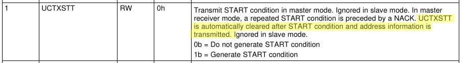

I'm writing a basic I2C library for the MSP430F5529, and I've noticed some conflicting information in the family reference manual for the MSP430F5xxx series. Under the I2C register description section, the UCTXSTT bit (which generates a START and also sends the peripheral address) reads as follows:

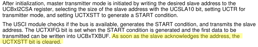

It says it is cleared immediately after the START and address are sent. However, in the section describing how to start communication with a peripheral, this is what it says (emphasis mine):
The problem is that this doesn't seem to be true. If I set a while loop to poll for UCTXSTT being cleared, it *always* passes, even if the peripheral has sent a NACK (I can see on my logic analyzer that it is indeed sending a NACK). So the information from the register description section seems to be true. If I send a START condition, and then go into checking for UCNACKIFG in UCB0IFG, even with a delay, this also gets skipped even when the peripheral is sending a nack:

EDIT: Looking at the flow chart on page 1006 (right after the Transmitter Mode page) it seems we must load the TXBUF first, and then check for NACK on address. So, I tried using this mess:

EDIT 2:
I was very close with my first edit, but I just needed to check UCTXIFG before sending data, then wait for UCTXSTT afterward:
    case WRITE:
        UCB0CTL1 |= UCTR + UCTXSTT; // send a START and address
        while (!(UCB0IFG & UCTXIFG)) ;	// wait until data can be written
        UCB0TXBUF = *(data + i); // we have to send the first byte to be able to check if an address nack happened
        while(UCB0CTL1 & UCTXSTT) ; // wait for start condition done
        if (!(UCB0CTL1 & UCTXSTT) && (UCB0IFG & UCNACKIFG)) {
