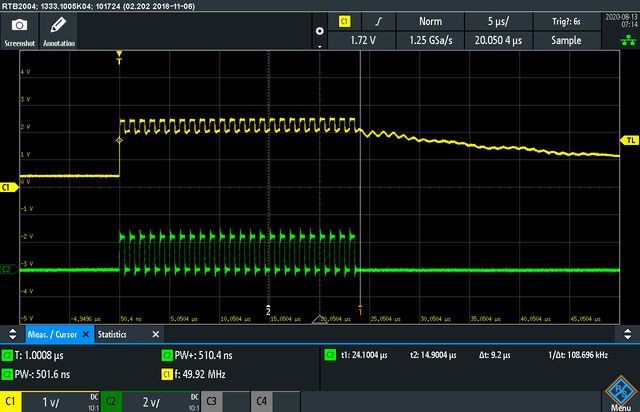

Also I've been working with TDC1000 and TDC7200, and I understand why I get signals like this:
1.yellow- send signals
2.green - receive signal

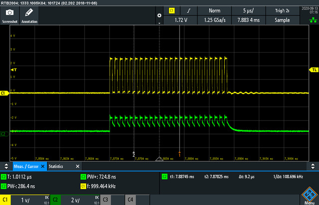

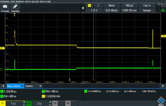

But when I'm using the MSP, I'm getting different signals, like this:
- yellow - J601
- green - J602
1.Two signals
2. Signals on the left
3.Signals on the right

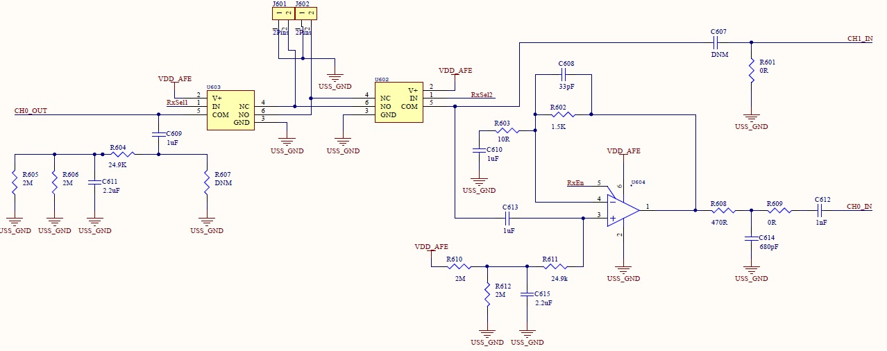

The pictures were taken when I didn't have the CH1_IN, CH0_IN and the transducers weren't connected to MSP, so I don't understand where the second signal is coming from.
