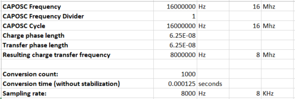

    Let's assume you have only one sensor and it has a target conversion count = 250 and you are using an F/4 (as shown in the GUI) which is 4MHz.
    Since the conversion requires 2-clock cycles, one for the charge phase and one for the transfer phase, so the effective conversion rate is 2MHz or 0.5usec period.  This means the sensor requires 250 x 0.5usec = 125usec to perform a conversion.  Assuming this is a self capacitive sensor, then additional capacitance (typically from a touch or whatever it is you are trying to detect) will lower the conversion count by say 10% so the time is a little shorter.

    Thank you for your very detailed answer! It is correct that I use a single sensor and one cycle. The example that you provided is exactly what I also tried to do, strip all code that is not necessary and use the CAPT_updateSensor() method, and another try with the CAPT_updateSensorRawCount() method.
    By using the CAPT_updateSensor() method the execution time is 0.68 ms, by using the CAPT_updateSensorRawCount() the execution time is 0.55 ms. I tried your suggestion to set bLpmControl to true and use the CAPT_updateSensorRawCount() method and measured that the execution time is around 0.48 ms.

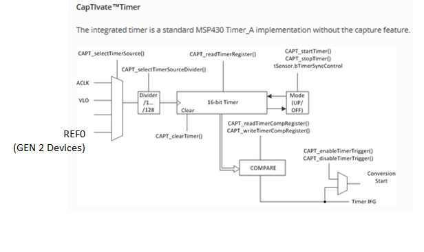

  • Hi Randy,
    The captivate timer is actually sourced from the ACLK by default in the startup software, operating at 32KHz.
        MAP_CAPT_selectTimerSource(CAPT_TIMER_SRC_ACLK);
    The macro CAPT_MS_TO_CYCLES  = #define CAPT_MS_TO_CYCLES(ms)     (ms * 32) so it is only a multiplier of the 32KHz clock period.
        MAP_CAPT_selectTimerSourceDivider(CAPT_TIMER_CLKDIV__1);
    A value of '1' for the .ui16ActiveModeScanPeriod results in a compare register value of '32' -> 32 / 32768  = ~ 1msec.
        MAP_CAPT_writeTimerCompRegister(CAPT_MS_TO_CYCLES(g_uiApp.ui16ActiveModeScanPeriod));
    You could bypass the macro CAPT_MS_TO_CYCLES(ms) and pass a value directly.  For example, if you used a value of 10, that would translate to 10  / 32768 = ~305usec.
    Here is Captivate timer illustration for reference. I'm sure you have read through the Captivate Technology Guide, Technology chapter, but for those reading this, here is a link that describes more.
    In regards to using any of the MSP430 general purposes timers, yes, you could set one up and poll.  This works perfectly fine, but you could do the same with the Captivate timer using its CAPTIFG flag, which is exactly what the default code uses in the CAPT_ISR.  This is more power efficient, which is important for battery powered applications since the MCU can enter its low power state in between the interrupts.  Since speed is the goal its probably faster to setup a timer and just poll it's IFG bit (with IE bit disabled) in a tight software loop.
    It is possible to set the timer up to automatically kick off the conversion and you can use the EOCIFG flag as a notification.
    I have attached an example main.c showing how to do this.  The timer will automatically trigger the next conversion while the CPU remains in LPM0 until an CAPT_END_OF_CONVERSION_INTERRUPT is generated.  The time to read the raw results takes about 2.5usec.  You could probably make it go a little faster by not enabling the EOC interrupt and have the CPU sit and poll on the EOC flag.  Not sure this will help though because the biggest delay is the conversion time itself (100s of usec).  Give it a try.

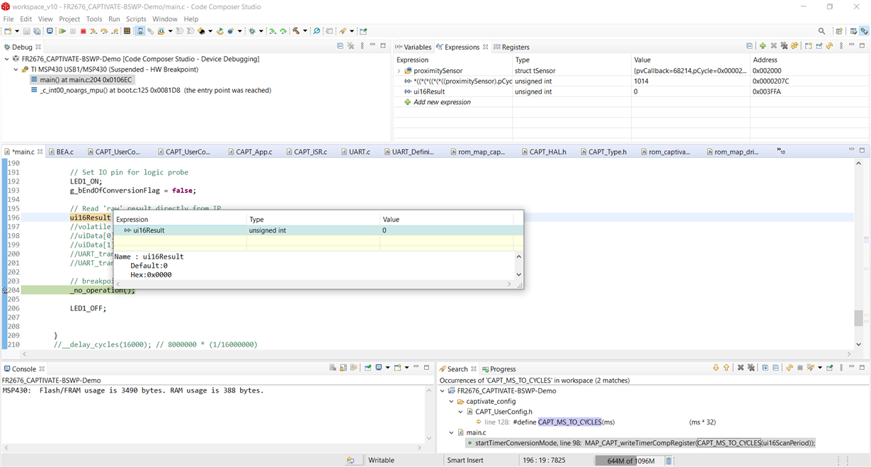

  • Hello Dennis,
    Thank you for your answer! I tried the suggestion that you made and this solution seems to work. I have seen that with a low count value the execution time can be reduced to 1usec when polling and to 2-2.5usec when using the low power mode mode. I will continue more testing tomorrow.
    The code seems to work now since direct registers are accessed, I could not find out the function implementation of the CAPREG16() method and of the "hidden peripheral registers" in the datasheet of the microcontroller or in the technology guide. Is this something which is available for everyone?

    When I decrease the compare register value, the CAPREG16() function does not output a stable value. If the compare register is close to the correct value it will incidently output a 0, when the value is not even close to the correct compare register value it will only output 0's. This same behavior happens when the poll frequency is to high.
    When I calculate the conversion/sample rate based on the CAPOSC frequency and frequency divider I have a theoretical sample rate of 8KHz, see calculation below.

    Here the is complete calculation.  What's not documented is a 20us stabilization required by the AFE at the beginning of each conversion.  Also, disabling the LDO warmup  (.bLpmControl = true) saves additional 125us, so in your 1000 conversion count case you are actually topped out at 6.8KHz.
    You are correct - If you set the Timer's compare value to 20, you calculate 1638Hz (610usec period).
    So you are attempting to read the timer register, not the compare register - correct?
    A word of caution, although if you are using ACLK or REFO clock for the Captivate timer source this shouldn't be an issue:

    Thank you for the information. The LDO was already disabled, e.g. .bLpmControl was set to true but it is good to know that this has impact on the time. I now understand that the maximum frequency should be around 6.8 KHz when the count is set to 1000 because of the stabilization time that I didn't add in my calculations.
    I'm not really sure what you mean with the question: "So you are attempting to read the timer register, not the compare register - correct?". I am not attempting to read any timer register or compare register but trying to read the raw count from the register using the method CAPREG16(&CAPCVD0, ...). However, I use the captivate timer and the compare register to retrieve the value. As I understand the maximum frequency for the count value is 1000 is 6.8 KHz, so if I use a compare register value of 5 (32768 / 5 = 6553.6 Hz then I should be able to retrieve the raw count. See image for the code section where I set the compare register to 5 and the ACLK is selected.
    When running the code with compare value 5, I still do not retrieve any value from the register, see debug session image:
    I was expecting that this would work since it now matches all the calculations that were made, however the register still returns the the zeroes. I hope that you have some more suggestions for me, because I think that we are almost there.
