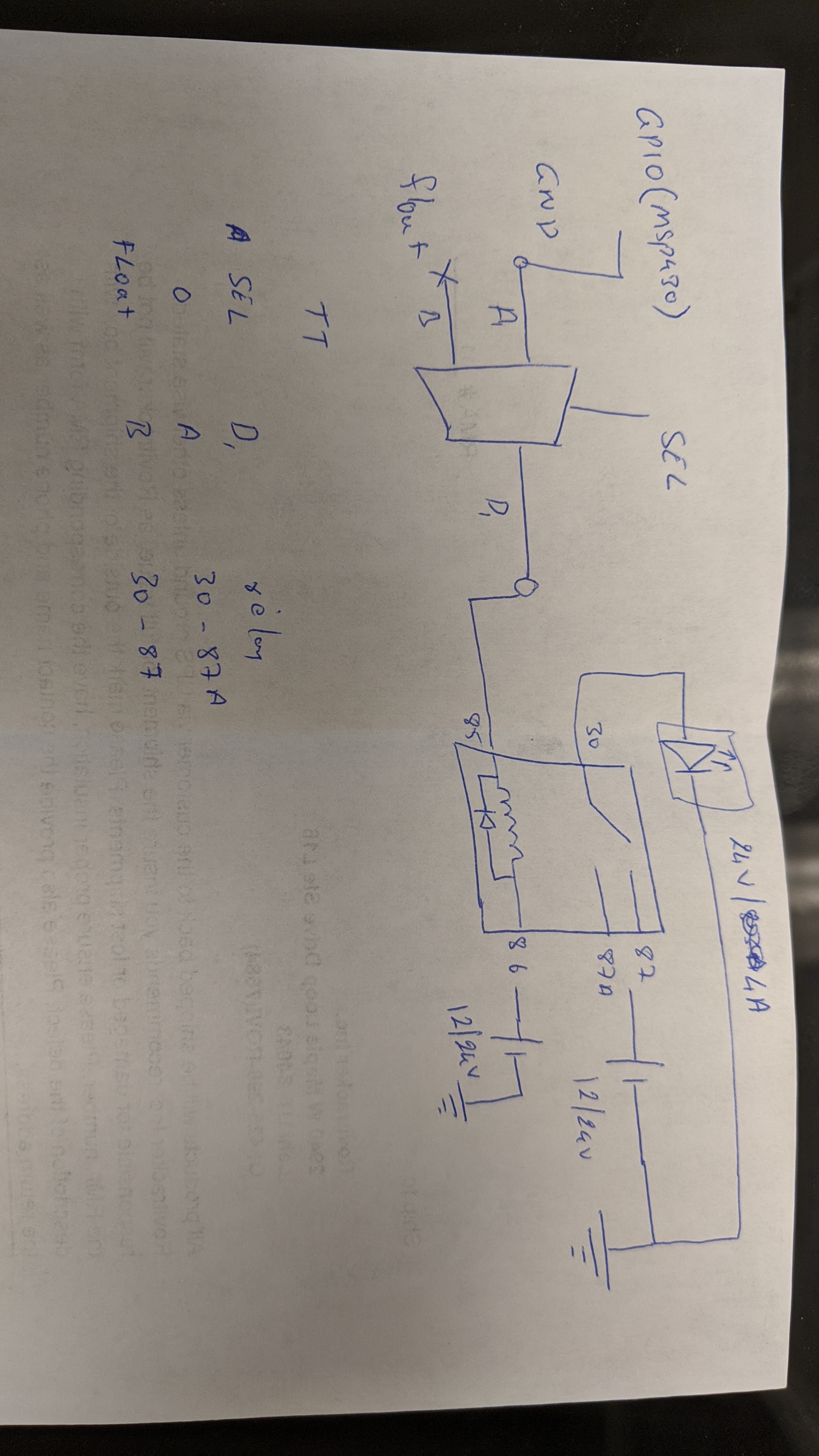

I'm working on msp430fr2433 and was wondering if it's possible to float a GPIO. I need this GPIO to control a relay. I'll connect one side of the coil of the relay to 12V while the other will be connected to GPIO.
When GPIO is GND, the coil conducts and the relay turns ON.
When GPIO floats, the coil doesn't conduct and the relay turns OFF.
Is it possible? or you guys recommend using a FET or something.

  • How about I use a MUX.
    SEL line will be connected to GPIO configured as an input.
    A of the MUX will be connected to GND
    B of the MUX will be connected to nothing. Float.
    GPIO input 0 = GND at the output of the MUX
    GPIO input 1 = Float at the output of the MUX
    Will this work? Certainly easier than a transistor driver right.
    Varun R
  • Does the MUX have clamping diodes?
    Pretty much nothing is simpler than a transistor relay driver.

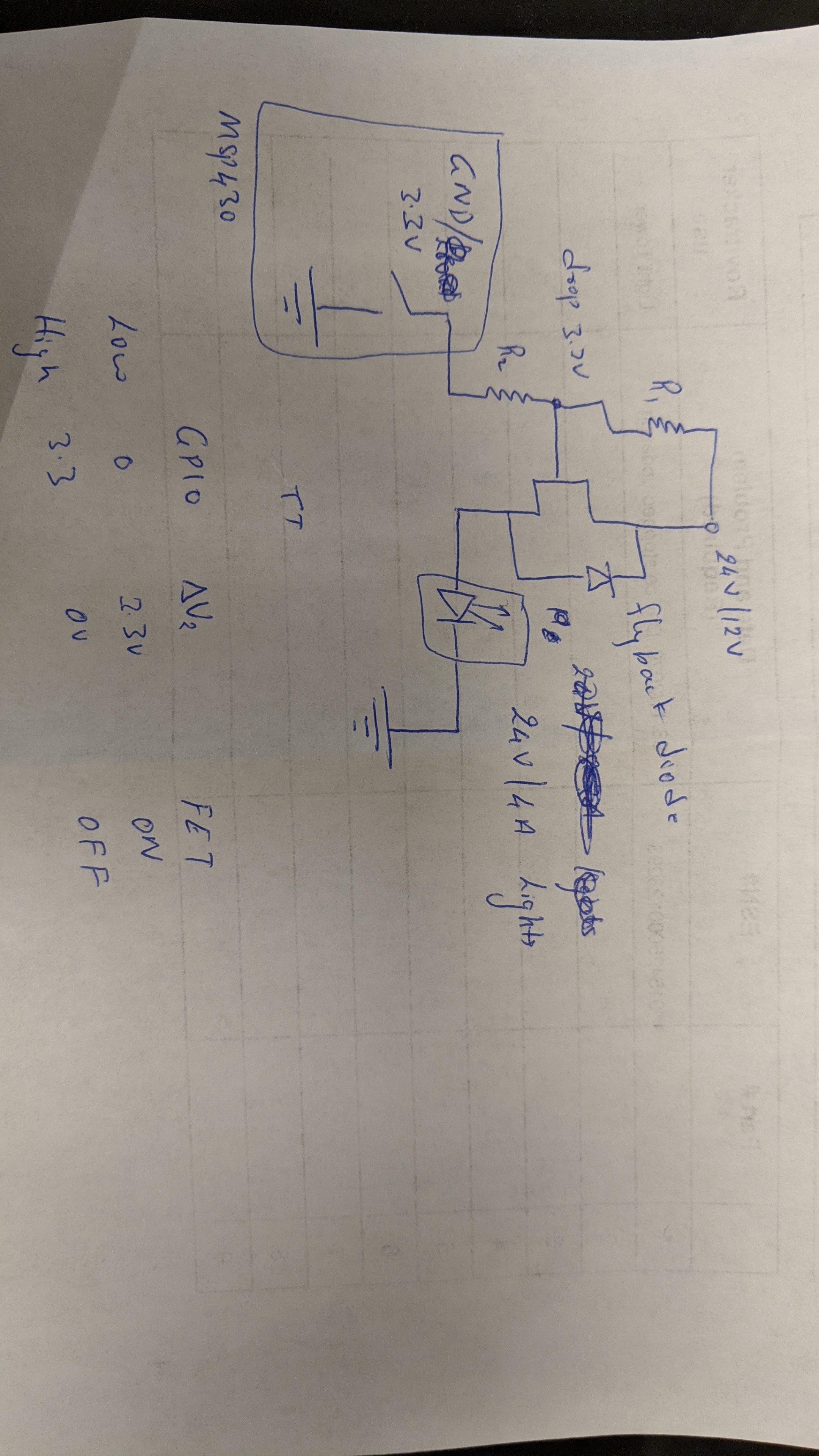

  • I'm still thinking of a circuit that would serve the purpose. Does it need clamping diodes? one input of Mux is connected to GND while the other is not connected. The output of the MUX is connected to a relay coil which has an inbuilt flyback diode. The relay is connected to a 24V battery to LED lighting which consumes 4A at 24V. I am using NC configuration for the relay.
    I have attached the circuit diagrams of how I plan on implementing this. one is via MUX while the other is with a FET.  Please let me know which one is the best. You can say neither as well. I'll work on it more.
  • Be aware that I had edited my last post to remove some errors.
  • Not enough. Placing the NPN transistor on the high side of the relay coil limits the coil voltage to about 0.7V less than the GPIO output voltage.
    A resistor to limit base current is almost always a good idea.

  • The current transfer ratio of an optocoupler is typically too low to let it drive a relay but they can easily drive a transistor. Kind of complicated so you need to have a very good reason to avoid the simplicity of low side drivers.
    For multiple relays the ULN2803 is very handy.
  • I think I'll buy a couple of those ULN2803 devices. Thanks!

  • It is resolved theoretically. I'll go with a transistor which will drive a relay. Seems like the simplest solution. I ordered transistors as well. They should get here tomorrow. I'll try out the circuit. I hope it works practically as well.
    Thank you so much for all the help.
