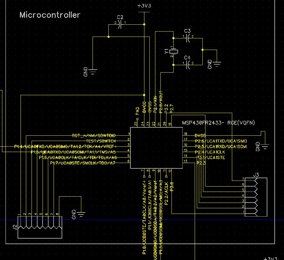

I moved my circuit from launchpad and developed a custom board for MSP430FR2433 which is integrated with an I2C sensor.
But I am not able to use the spy by wire link from the debugger section of the launchpad but am not able to program the microcontroller.
I am attaching the schematic of my circuit.
I have tried programming using Energia & Uniflash both.
Note: I do not have any pullup on SBW lines.
  • Hi Anurag,
    You need pullup a 47K Res in RST pin.
    Best Regards
    Johnson

  • The F5528 "ezFET" chip does give you access to the BSL pins (you need both Tx and Rx) but it doesn't give you direct access to the SBW pins, which you need in order to put your target into BSL mode.
    Given (1) that you need access to the SBW pins in either case and (2) the SBW programmer (in the F5528) provides much higher function than the BSL, I suggest you not use the BSL but rather just connect the Launchpad SBW pins (J101 USB side) to your target's SBW pins and program the target the way have have been doing it.
    FRAM devices are with internal pull-up on RST pin, so device should start-up without external components on RST pin. SBW works best without anything connected to device RST pin (with connected cap signal is "fighting" with charging/discharging). 2xx non-FRAM family is without internal pull-up, so external must be used for start-up, but FET should flash it even without it.

  • You can program (and debug) your target board using the Launchpad you already have. The MSP-FET will give you a few extra features that you probably don't need.
    Just connect the SBW (and power) pins from the USB side of the "bridge" header (J101) on your Launchpad to the respective pins of your target board, and run CCS normally.
  • I get it now. Use the launchpad to program target msp430fr2433 on my custom board by directly connecting the SBW pins. I will just disconnect the jumpers that connects it to the msp430fr2433 on the launchpad.
