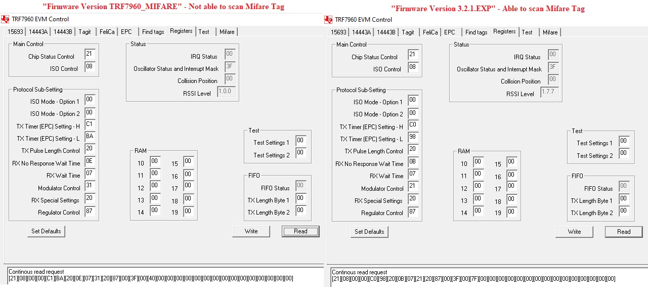

I am working in TRF7970A EVM for Mifare application.
I have the access to the "TRF796X_TRF7970X_MIFARE_12_2013" Mifare example provided by TI.

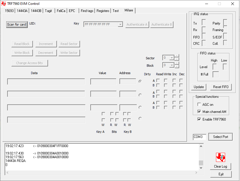

The TRF7970A EVM is in default hardware configuration. I programmed a binary from the mifare example which shows the version as "Firmware Version TRF7960_MIFARE". With this, I cannot scan the mifare tag. It looks like there is no response from the tag. Please refer attached image.

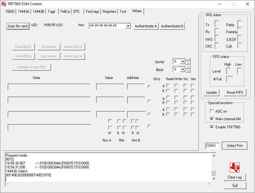

But I programmed another binary from the mifare example which shows the version as "Firmware Version 3.2.1.EXP". With this, I can able to scan my Mifare tag but could not authenticate it. It looks like the mifare authentication is not supported in this firmware version. Please refer below image.
Please find attached the register dump of TRF7970A in both cases.
I am using the Mifare 4K tags, which responds as ATQA = 0x00 02 and SAK = 0x18.
Please guide me to test the Mifare application successfully.
