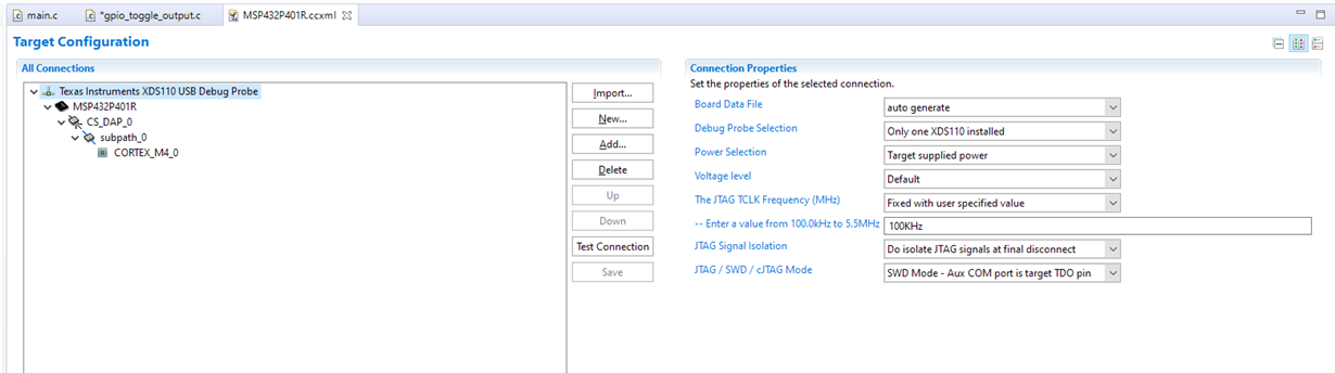

This is the error output:
I don't think the device is bricked, but I would like to be able to use this MSP432 for my project instead of the MSP430.
I tried multiple factory resets and also tried reducing the JTAG CLK frequency
I had previously run some simple GPIO code successfully on this board so I know it was working before I tried the code mentioned about. Apparently, as specified in the DriverLib Manual in section 6.6.2.23, pre-released launchpads can't use the setDCOFrequency() function to anything outside of the preset freqs, which I may have done.
In any case, that's what I know so far, and I would appreciate any help or insight on this issues so that I can save my launchpad

  • That message means you're trying to use a Black Launchpad, but evidently you aren't since you succeeded before. I expect what happened is you set the CPU clock to 48MHz without setting the Flash wait states. The CPU is telling the debugger some kind of nonsense, and that's the best it can guess.
    What happened exactly when you did the Factory Reset? It should have left the MCU erased, i.e. no program in it. Did you re-load that same program afterward?
