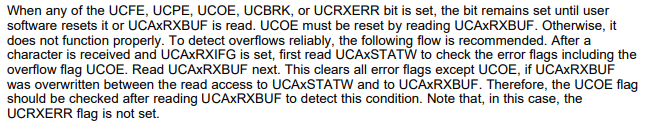

    The receive interrupt is triggered before the overflow occurs. If the overflow occurs, it indicates that the UCxRXBUF was not read and the interrupt was not processed? You will not get a 2nd interrupt as the 1st received word was not read/processed.
    Section 24.3.6 Automatic Error Detection of the Technical Reference Manual (www.ti.com/.../slau356) suggests the following flow to detect and handle overflow conditions:
