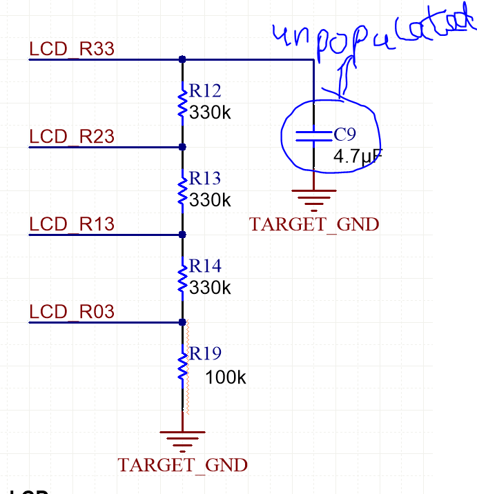

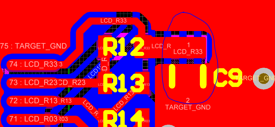

I have built a custom board based on EVM430-FR6047. The LCD I am using is (www.mouser.in/.../825-VIM878DPRCSLV ). Some of the LCD segments dont work in some of the copies of the assembled device. They dont work even after resetting the board. The segments dont work unless reprogrammed.The contrast is perfect but I havent populated the capacitor just like EVM430-FR6047. Could this be creating the issue?
  • Hi, Sagar,
    What is the COM, and bias for the LCD?
    If you are using the LCD module internal charge pump to generate the LCD bias voltages, you should connect 4.7uF on the pin LCDCAP./R33.
    If you are using external resistor divider to generate LCD bias voltages, you should connector resistor on pin LCDCAP/R33 pin.
    Please refer to the pin description, the section 5.13.9 and 7.2.2.4 in the MSP430FR6047 datasheet for details. There is also detailed description for operation theory and register configuration in user's guide slau367
    Lixin
  • Hello Lixin,
    I am not sure about the bias voltages. How would I be able to check that. I am using a resistor divider with the schematic and code attached. I had tuned the R19 resistor value to set the contrast I require. I am using the default code inititalization as for EVM430-FR6047. I think the internal charge pump is not used. Do you suggest any changes both from schematics and firmware perspective for a stable result? Or some experimentation required?

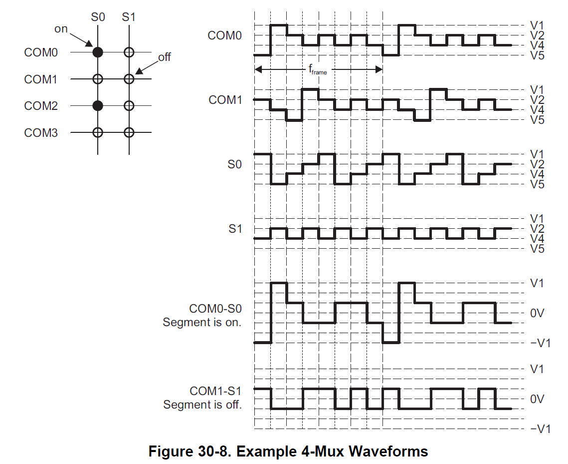

    Bias voltages are the different voltage levels on the LCD signals. In the LCD chapter of user's guide slau367, you can find the LCD signals as following figure for 4COM LCD.
    You can measure the voltages on the LCD pins or the 4 pins R03/R13/R23/R33 to check if the voltage levels are meeting the LCD specification.

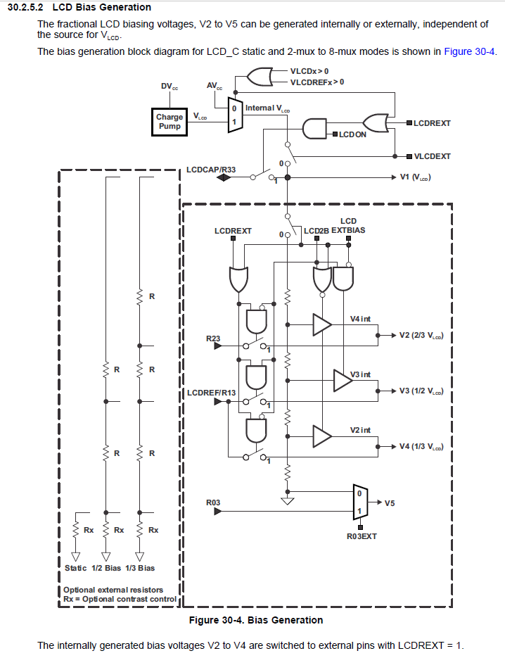

    This is the register LCDREXT description.
    When LCDREXT set to 1, internal charge pump will output voltages on V2 to V4. Section 30.2.5.2 in the user's guide has the detailed description.
    I am confused with the statement "switched to external pins".
    Prudhvi Sagar
  • There are switches to control the output the V2-V4 to external pins: R13, R23, R33.
    Lixin
    So this is used to utilize the Resistor divider to set the bias voltage? Can the internal charge pump and the resistor divider be activated simultaneously. So can the pin R33 be connected to a resistor and a capacitor simultaneously?
    Prudhvi Sagar
    There are 2 options for bias generation:
    1. Use internal charge pump, with capactor on R33 pin.
    2. Use external resistor divider.
    These 2 options cannot be enabled at the same time.
    So pin R33 cannot be connected to a resistor and a capacitor simultaneously. But for option 2 (resistor divider), the capacitor on R33 may not hurt the bias performance, which works as a de-coupling cap. Then that is fine to have the capacitor.
    Lixin

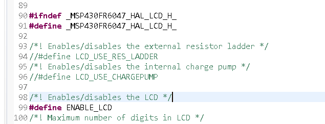

  • Hello Lixin,
    I have tried the 3rd option as attached, it still works. My main issue is on prolonged usage, some of the segments die and do not work on a reset as well. It requires a complete re-program for it to work. Is this an issue which you are already aware of? Why does this happen? I am planning to run the devices with the 3 options and then check which one doesnt die.
    Prudhvi Sagar.
